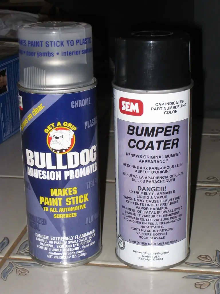

Painting bumpers AGAIN, should I use an adhesion promoter?
Well this is the third time I've attempted to paint my plastic trim around the bumpers. Every time I do it, it ends up peeling and looking like sh*t within a week or so.
I used bumper coater the first time with no adhesion promoter. Lasted all of a few days before I noticed patches where it peeled off.
So I painted them a second time. This time I used an adhesion promoter followed by DupliColor trim paint. Lasted a little more than a week then I noticed the same peeling yet again. One thing I will note is that I didn't sand or attempt to strip the leftover patches of paint from the first job (but a helluva lot of it peeled off already). Perhaps that caused the second coat to peel?
So here we are, third time's the charm, maybe? I sanded the plastic as best I could, but there's still some black paint in the little ridges and grooves (as you know, the bumpers are textured and not smooth) and used some stripper. I picked up some Krylon Fusion for plastics at Wally World. So my question is, should I use an adhesion promoter with this too? Or will it let me down again? I really don't want to paint this again in a few weeks.
Also, any other prep-work or tips you can offer would be appreciated.

I would recommend using the adhesion promoter and paint I used. Picture is in the link, but here's a shot anyway:
I believe it's DupliColor adhesion promoter.

So what do you think, should I use the adhesion promoter I have or skip it?
Also, what kind of prep work did you do? I've been washing with dish soap, degreasing, then painting.
