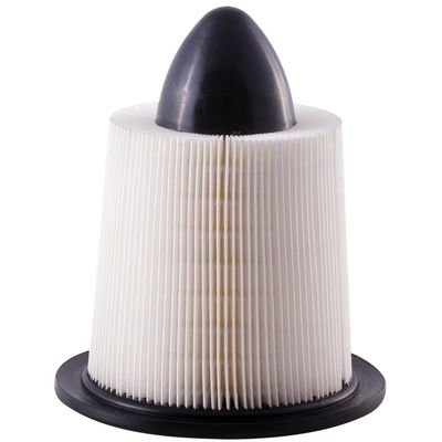

..Stock filter about $16..
4

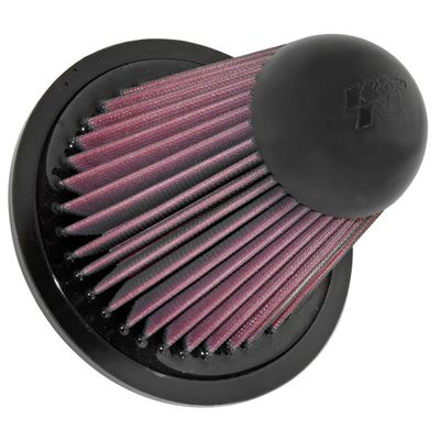

..K&N drop in about $50..
4

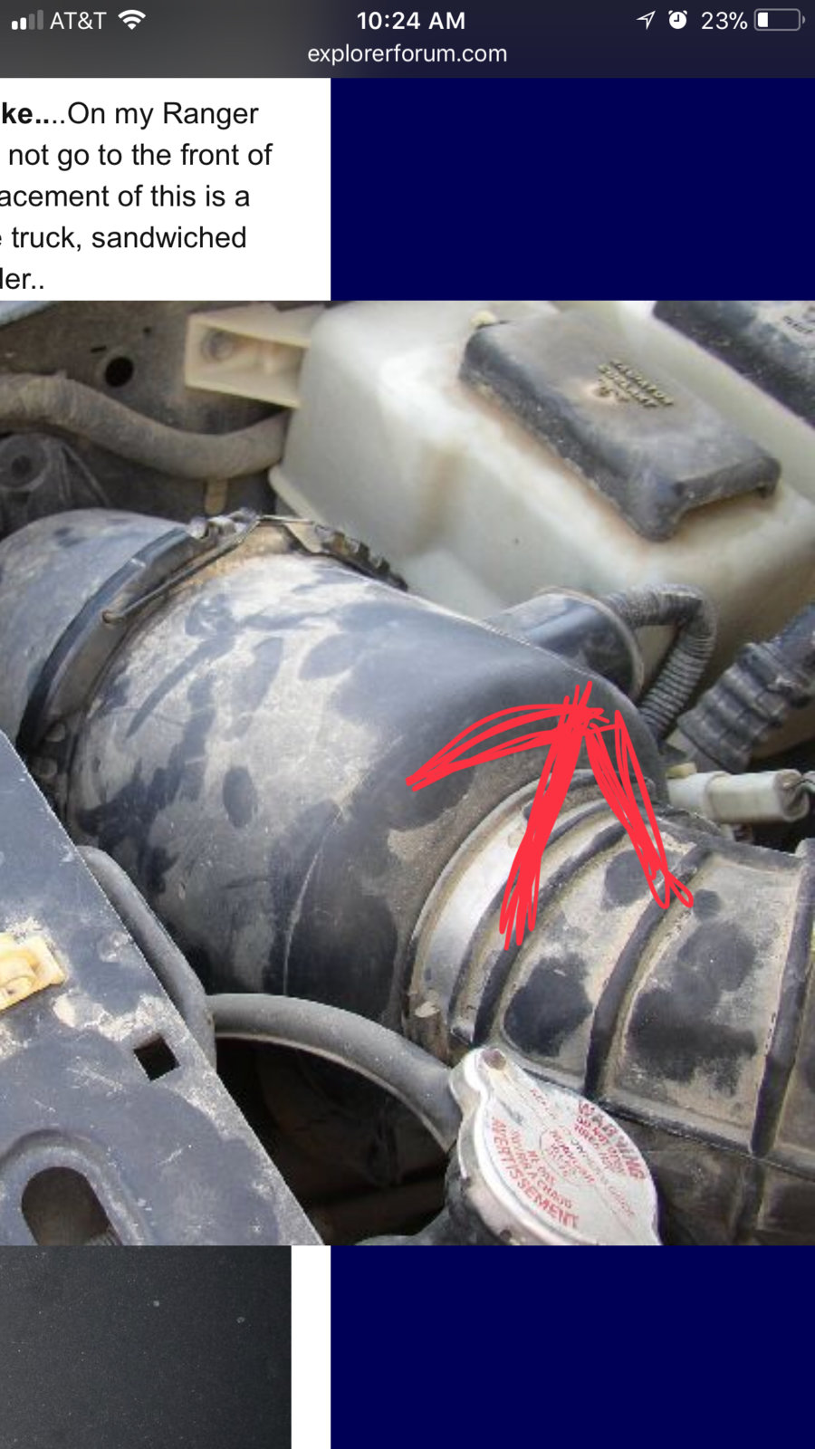

Tbar,
What did you do with the electrical plug that went into the original box where the air filter was?
So, when you took that box and snorkel out and put the cone air filter, where did you put that electrical plug?
Thanks for your time and this thread.
