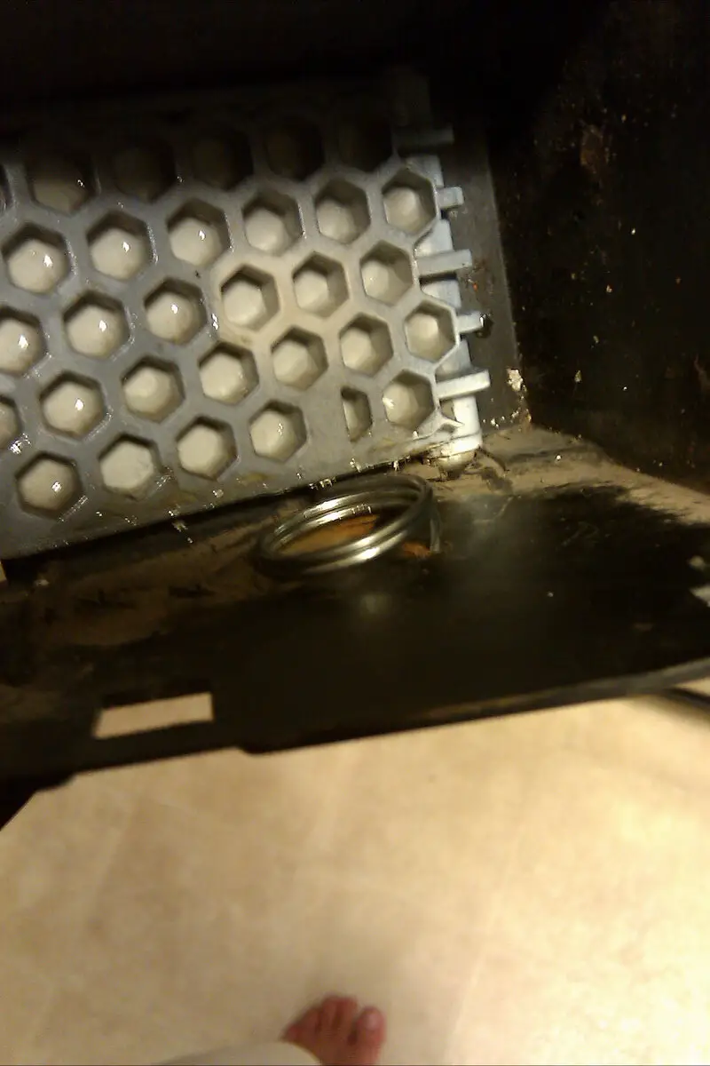

Ok, I figured it out. Went and bought a spring at advanced auto parts (spring about the shape of a quarter ). Cut off 2-3 coils, bend the ends to 90 degree angles using vice, and it works perfectly. Attaching pictures incase anyone else is wondering what it looks like. Sorry, on camera phone but you'll get the picture... literally.
I just finished this fix and it was fairly easy. I got torsion springs from NAPA but also found them at my local True Value after the fact. To bend the arms, you need to be fairly careful, I broke off the first try.
Start the bends about 3/8" from each end of the spring tail and make the bends go down towards the spring not up and away. This will make it sit better in the housing. When you're finished the tips should be about 1 1/4" apart. Fit one end into the small hole in the arm and the other into the hole in the case and your good to go.
