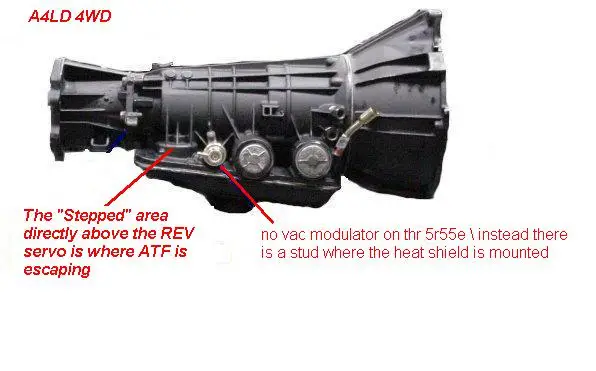

Small crack on a 5r55e (just above the REV/LOW servo). It is causing the REV line pressure to escape (leaking in REV profusely) and no REV. I am gonna try JB WELD, but I was wondering if anyone else has experienced this? What did you do to fix it?

Anyways My Crack (snicker snicker) looks like it is coming from the pattern seams (where the casting patterns meet up in casting) it almost looks like when they were removing the excess flashing they removed too much?
200 psi in my transmission? I thought line pressure was lower than that?
here is a pic to better describe where it is leaking:
Right near the step for the REV LOW servo, assuming thats why no REV??? I am hoping it is that and not that the band broke and hit the side of the case causing leak -
