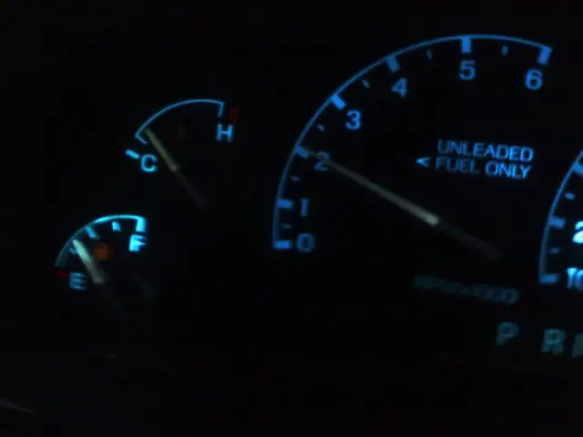

While driving, my engine temp seems to stabilize at about 182 degrees, according to scanguage, but the needle on my dash stabilizes as follows:

What temp thermostat are you running?
If you are running a 180F thermostat, that temp is accurate on the scangauge... If you are running a 195F[oem] thermostat, then it is stuck open since engine temps should be around 192-197 F..
I'm not sure, I'll crack it open today before I start it and get a part number..
It's brand new though.
Ok, part #13958 from Advance Auto, 180 degree thermostat. It's my fault, thought they were all the same..

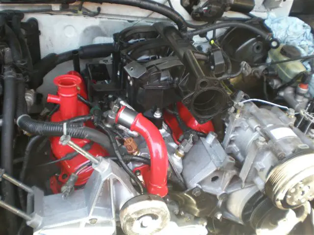

This picture is the lower intake with the coolant gauge sensor on the left and the ECT sensor on the right both on the front of the lower intake...The one to measure is the one with the 2 leads...
I can only think of 2 items left; If you look at the charts for the ECT and IAT sensors they output a voltage dependent on the engine temperatures...With a voltmeter I would verify that the voltage they are outputting is proportional to the temperature they are seeing...If those both pass, then look for a restriction in the airflow system starting with a really dirty air filter...

...I can only think of 2 items left; If you look at the charts for the ECT and IAT sensors they output a voltage dependent on the engine temperatures...With a voltmeter I would verify that the voltage they are outputting is proportional to the temperature they are seeing...If those both pass, then look for a restriction in the airflow system starting with a really dirty air filter...
EUREKA!!
I got a little confused pulling up some threads to research a little more info on the sensors after what you said, but, to my understanding there are two ECT sensors on the motor, one to send temp to the PCM, another to send the info to the instrument cluster. Obviously ScanGauge uses the one that is sent to the instrument cluster.
With power on it, the ECT to PCM sensor was putting out just under a volt, when it should have been putting out somewhere around 3.2v at 50 degrees.
(according to FordFuelInjection)
