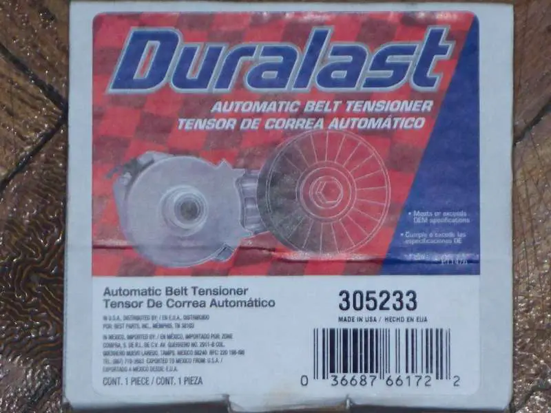

Here is a picture of the kit that is used on the 3.0L engine:
It was purchased in Autozone, and came complete with the pulley, and installation hardware. I replaced both idler pulleys at the same time, but had a problem with the ones that they gave me. The OEM pulleys were metal with a smooth surface. The replacements were slightly smaller, plastic, and had raised sides. As a result, I had to use a larger pulley on the idler to compensate for the smaller diameter of the two idler pulleys because the belt was too loose. Here is a side by side comparison:

sorry to hijack this excellent thread but someone needs to tell Duralast that their Spanish translations are a joke to people whose native language is Spanish. Have you ever been to an autoparts store and seen hispanics laughing while they look at parts? they are laughing at the translations in the packaging.
For example: Look at the images of the Duralast Pulley Tensioner above;
the word "Correa" means "Belt" in Spanish, but not an AUTOMOTIVE BELT,
"Correa" means a Man's or Woman's waist belt. Can you see why they are laughing? Hispanics don't go to Autozone to buy a waist belt!
the correct translation for an automobile Belt is "Poléa", pronounced: poh-lay-ahh.
a "Poléa" is a strap used since ancient times in sawmills, windmills, steam engines, and in modern times, in automobiles, tractors, and other mechanical equipment.
a "Correa" has also been used since ancient times but at the waist of humans, whether it was a rope, or a leather strap with a buckle, or what have you. But the bottom line is that a "Poléa" is NOT a "Correa" as the Duralast packaging reads.
the only time in modern times that a "Poléa" was used as a sort of "Correa", was with those machines of the 1960's that vibrated a belt (Poléa) around people's waist when they were trying to lose weight.
when it comes to engines, the correct word is "Poléa". It looks like Duralast and many other companies are trying to save a buck going to online translations instead of hiring professional translators.
Again, sorry for the interruption and I hope nobody gets offended.
