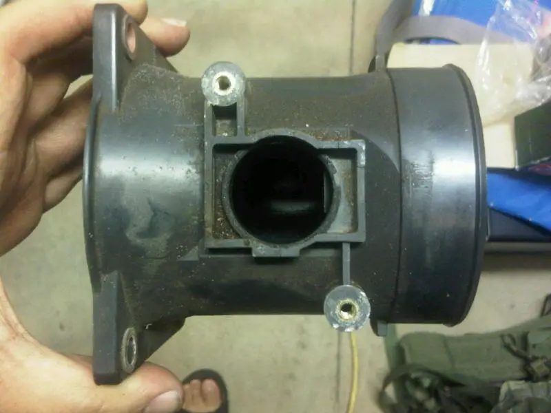

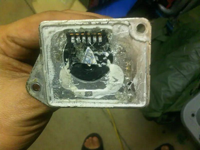

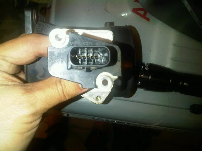

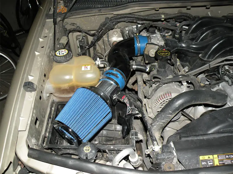

OK guys, I want a real CAI from K&N for my (04) 4.0L....so, i'm gonna construct my own MAF unit for my X. I went to the local junk yard today and picked up an 02-03 MAF housing from an explorer for my mod. I intend to use the mounting plate from the 03 MAF (see pic) and dremel it out (as well as the housing unit) to make the 04 MAF sensor fit. This will eliminate any wire splicing and should provide a perfect fit for K&N 57-2537 CAI kit. What do you think? I also snagged the crank case vent tube for a perfect fit. I've got to work tomorrow but will work on the mounting plate for the 04 MAF. I'm gonna go out on a limb and order the K&N kit as i'm confident this setup will work.
1) pics below show the 02-03 MAF Housing with MAF removed
2) original maf with cover removed to expose the mounting plate that i'm going to dremel out to fit the 04 MAF sensor to mount to it
3) a pic of what it SHOULD look like when I'm done!
