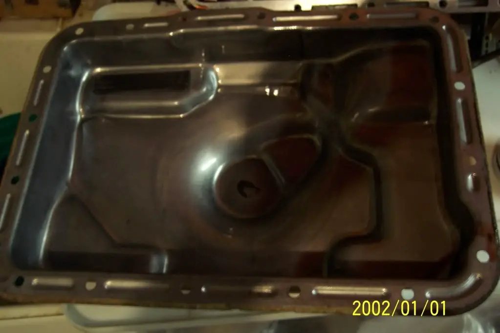

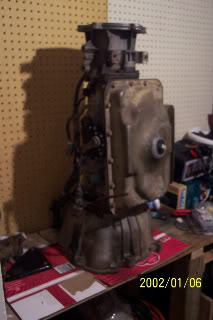

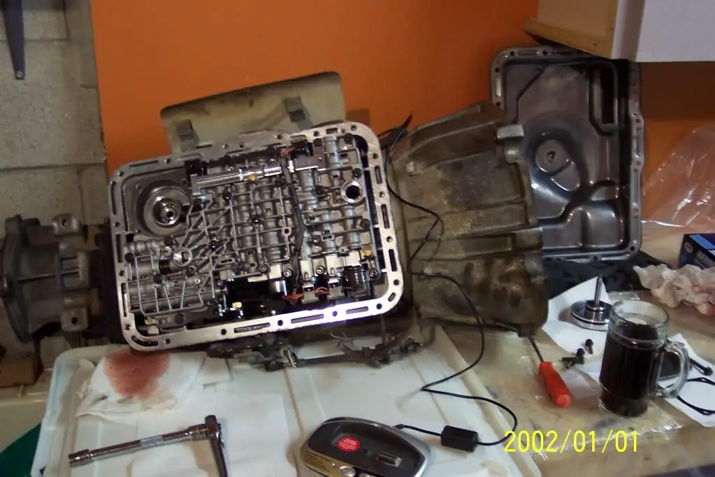

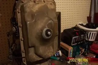

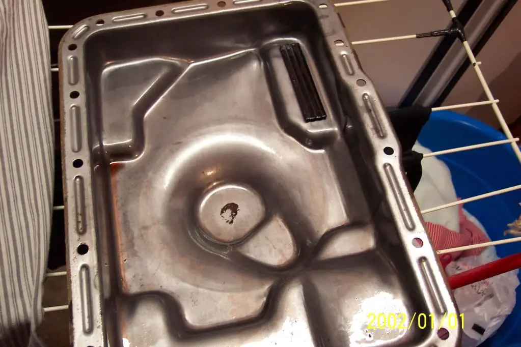

Here is the tranny I bought - just an initial observation and a drain plug mod
when I opened the pan I was relieved to see how clean it was.
almost no metal powder on the magnet!

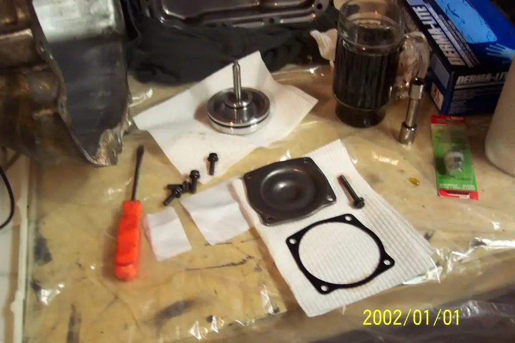

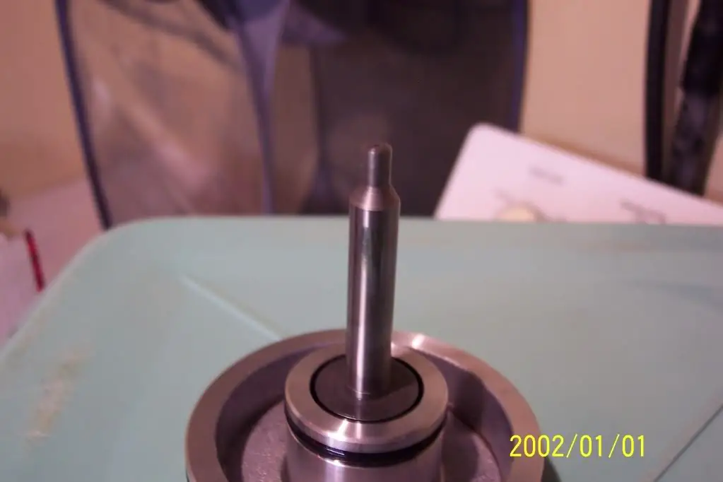

inspected the Reverse Servo and Bore
the servo shaft shows minor wear, but this IMO is where the death sentance with the 5R55E transmission begins...
I wish I had a better camera - on the tip of the servo is shows tiny hairline fractures - but the tip is not broken (yet)
In the very near future I will install a new servo... but it will have to do for now.

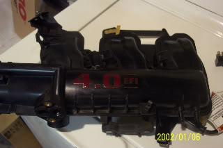

Yikes what a PITA! Anyways --- as long as I have it ripped apart I decided to clean up the upper intake plenum and get a lil fancy with some model paint...
:D its the little things :D
-Mike
Nice Mike- I like it! :thumbsup:
Fix the backwards front roof rack crossbar. It's the little things... :D

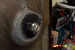

Also...
put in a tranny drain plug
busy nite :D
HAHAHA! Extra HA! I just noticed that when I was looking at my thread - funny
You would have a stroke if you saw the interior... pics to come.
nice lookin sport
Thanks Sam - it's gettin there...
Nice! Like the drain plug mod too. Makes me want to get some model paint out as well.
