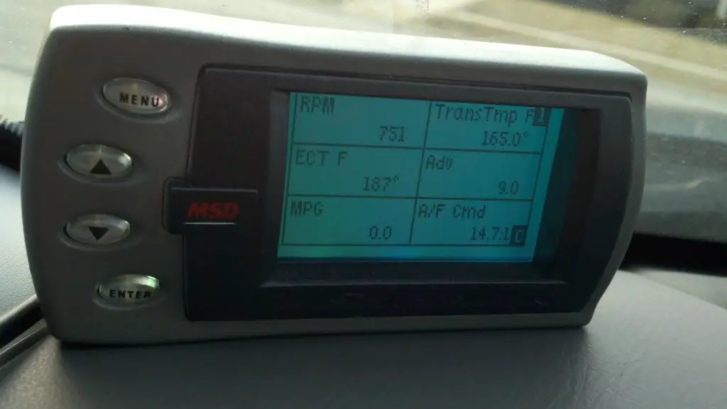

Here is how I have my dashhawk setup. There are many different parameters to watch.

Thanks for posting that. Would be interesting to see the difference in trans temps while towing in OD.

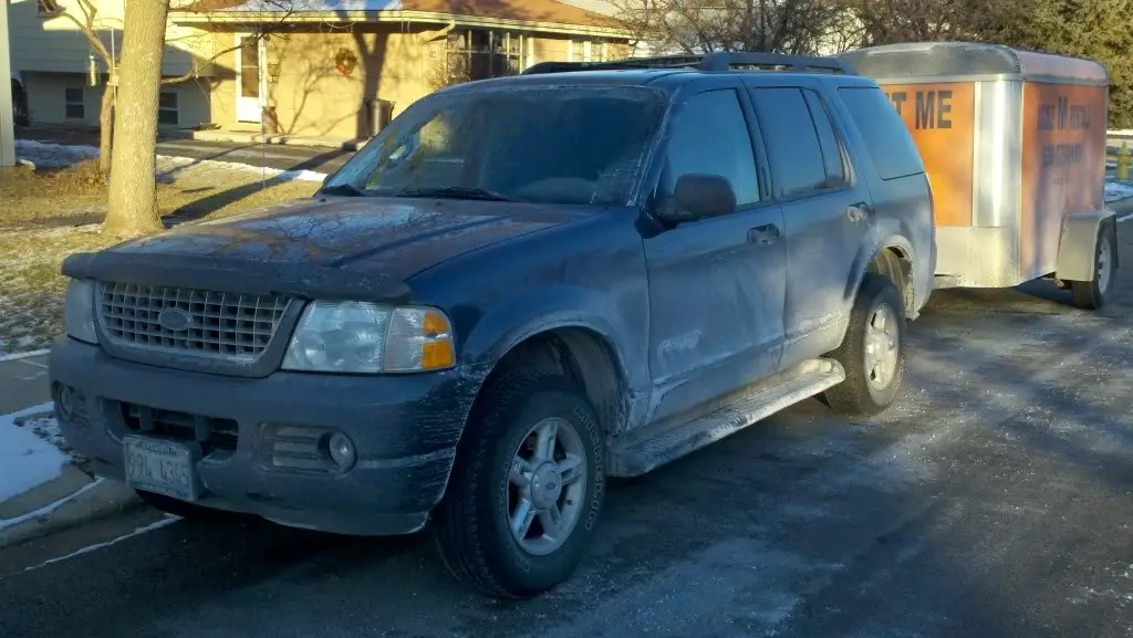

With all the salt, here is what my truck looked like after.
