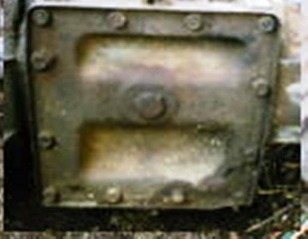

how can i tell if its an m5 or mitsubishi? i know what my 2wd m5 looks like but never really messed with 4x4, also does anyone know if i will need any crossmembers off the donor, or if my driveshaft will work?
If it has a pan on the bottom with 12 bolts it's an FM.
thats easy enough, i assume the m5 will look like a 2wd with a different tail section?
