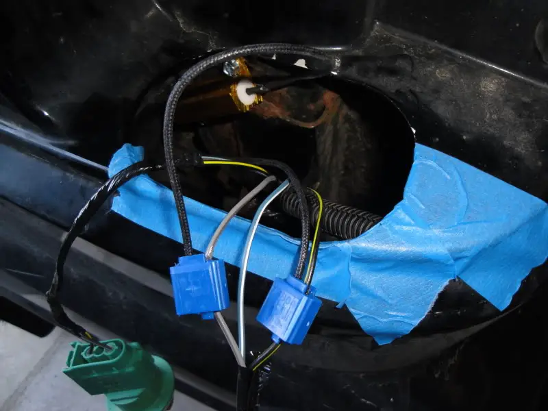

LR brake light: I managed to tack the resistor down to an exposed piece of the bed frame. The blue tape was used to protect the composite edge from the drill I used to start the screw. The wire crimp taps provided a clean and quick method to splice into the wires I needed. They were included with the each resistor.

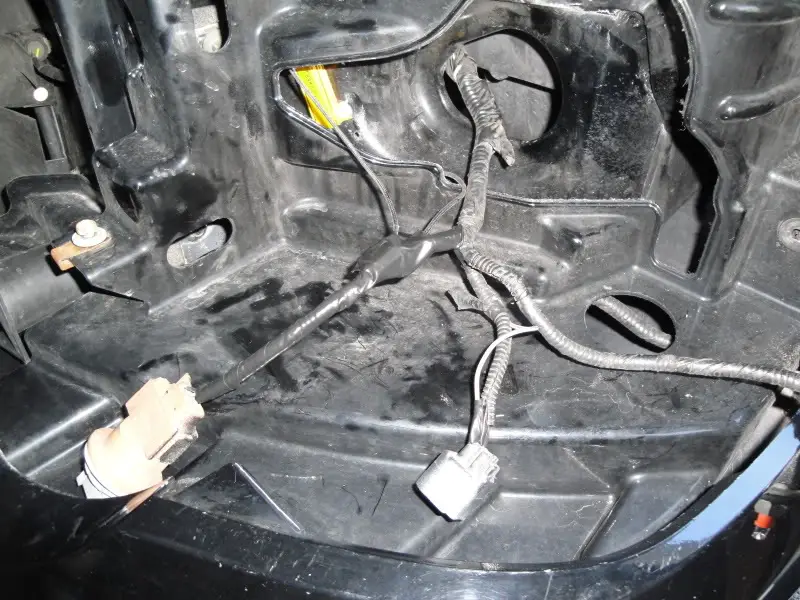

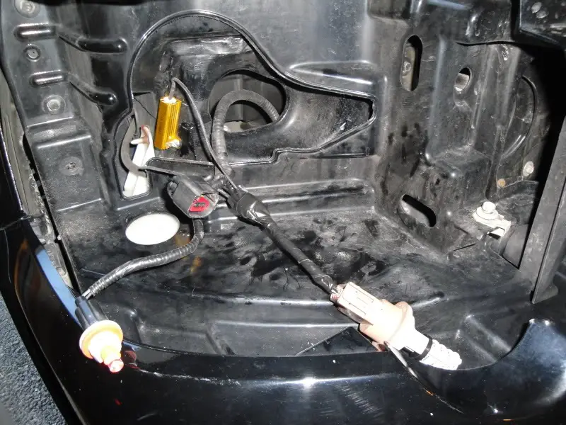

LF headlight assembly: I tucked the resistor in behind the headlight assembly as shown above.
RF headlight assembly: I had to find a different location for this resistor, because there was a large wire bundle behind the area where I had mounted the resistor on the opposite side.
Ignore my other post, I figured out the taillight issue, one of the bulbs isn't functioning correctly, I swapped sides and found the problem. As for the front, once I install the load resistor, either the front flashes at normal pace but won't glow when I turn on the lights or if I switch up wire positioning, it won't flash with the running lights on but it will glow. I tried it with 4 different bulbs, did you have this issue?
