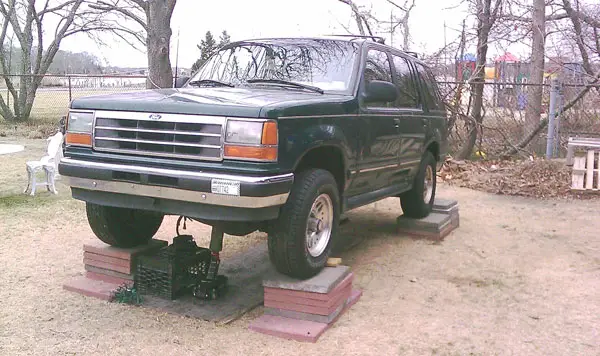

This weekend, we finally propped up the car dropped the transmission. Since I don't have a paved driveway, I didn't feel confident using jack stands. What we DO have is a bunch of cement tiles that we stacked up under the tires to keep her stable. Not ideal since it makes it more difficult to get the driveshaft bolts loose, but I just felt safer like this... parking brake set and wheels chocked:
Removing the transmission was very tight since we decided to keep the rusty exhaust system place. We also only disconnected the drive shafts at the transfer case and tied them up out of the way so we wouldn't have to disrupt the differentials.
