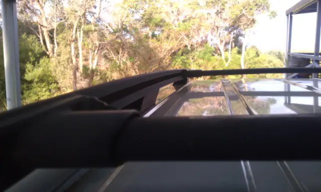

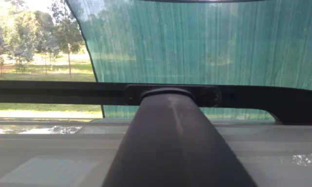

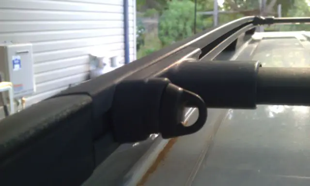

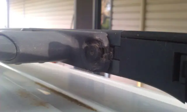

Will these pic's help?

Yeah they do, thanks a bundle. I think I've got the mount figured out, anyone know how to tighten the rails to the roof?
It's a pretty clean mount, you may have to go through the headliner to access those bolts, just guessing tho'.
Thanks man those are exactly what I was looking for.... Hopefully this thing turns out to be as cool as I'm picturing it.
If you need any additional pictures, let me know.
