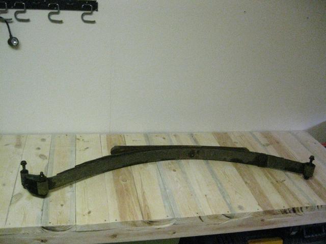

Found a pair of leaf springs for 65$ off an 1990 f150 with a 4 leaf 3800lb rear gawr setup. They were muddy and had a little surface rust. Broke them down, hosed them off and got them all cleaned.
f-150 spring

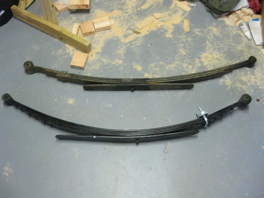

The rain killed my plan to get the rear done today. But I got the stock leaf springs off and in the garage before it started to rain.
2.5 inch difference between the old leaf spring and modified version. Handling feels a lot better now.
Before
After

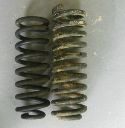

Just the f150 leaf springs, I was able to find some coils that are 2 inches longer so once I get those I'll put them on and add pics.
So what were the coils from?
I'd hate to see how much difference I'd get "fixing" the sagging, and worn out stuff.
Mark thanks for the clarification, this make me feel better about holding out till I get some other things handled before the shocks.
Coils I got from LBarr2002.
