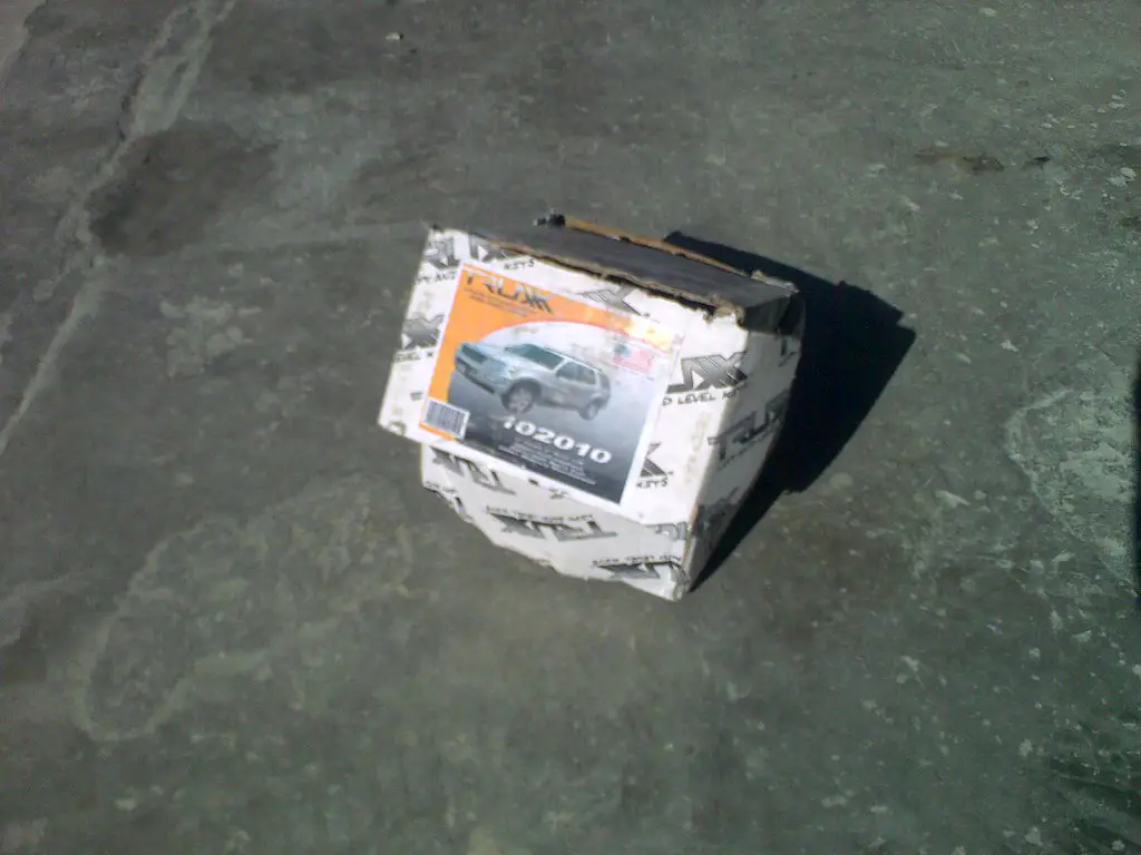

I done my lift using a combination of Truxxx leveling kit (strut spacers) #102010 and Rancho QuickLift Loaded
Truxxx leveling kit #102010 (Advertised Lift: front 2.5"/Rear 1.25")
here are the front spacers
and here are the rear spaers
Here is the Truxxx installation Guide:
http://www.truxxx.com/pdf/102010.pdf
