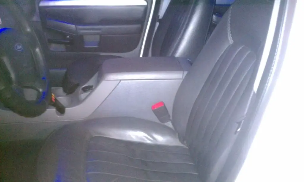

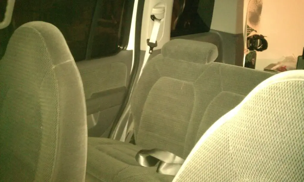

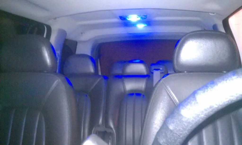

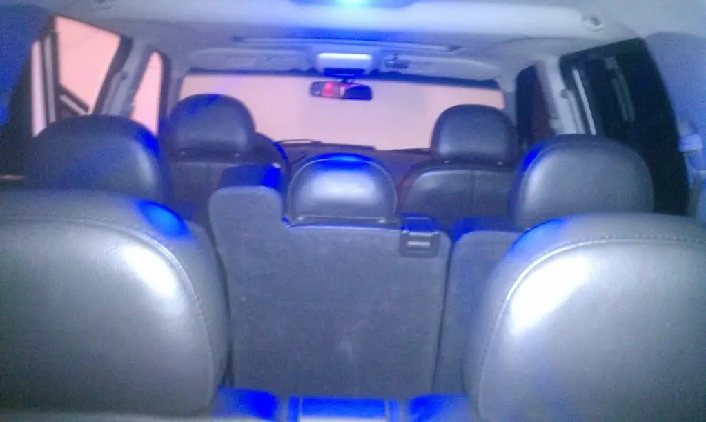

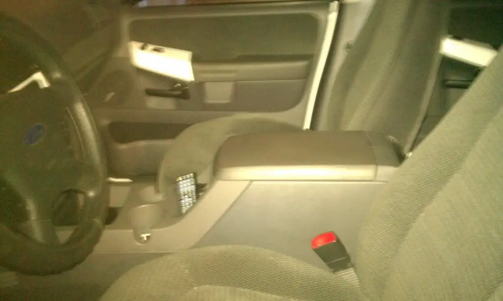

I'm making this thread for everyone who doesn't like their boring cloth seats or non existent third rows. I bought my explorer with 2 rows of cloth seats. 60/40 split in the back. Unhappy with what i got, i found a mountaineer in a near-by junkyard that had been totaled out in the front, with the interior completely intact.
Unfortunately i didn't take any pictures during the swap, but i do have before and afters. the swap itself was very easy, all i did was completely gut my truck and the donor vehicle, move around the studs in the floor of my truck to match the mountaineer, and put everything back together. all of the holes were in the body of my ex, you just have to uncover them(covered with aluminum tape) and seal up your old mounting holes. you will need the rear interior body panels in order for the seat belt tensioners to fit. basically, i swapped everything from the front dash back(door panels, all interior body paneling, even the carpeting to extend all the way to the third row
I went from 2 rows of grey cloth to 3 rows of black leather out of a 2004 mountaineer.
before:
after:

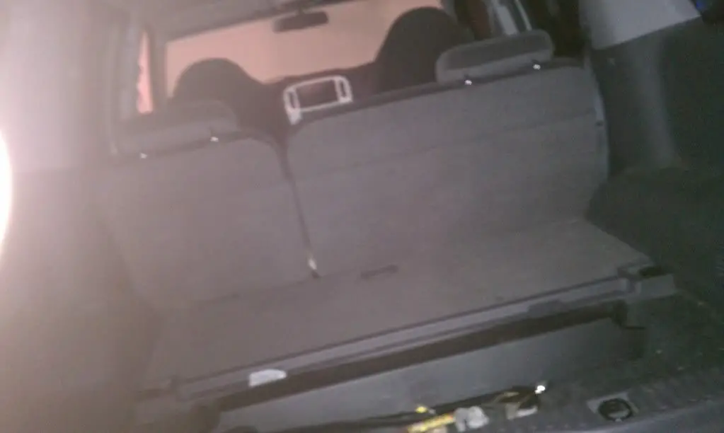

Im anxious to find a 3rd row seat for my 02 XLS, (cloth). I was wondering how hard it was to swap the 3rd row seat belts into it. Does the third row have shoulder straps or just lap belts? You said you also need the rear inside panels for the seat belts and tensioners?
in both pictures, you can see which trim piece you'll need (in order for the seat belt to pass through the pre cut slit) top piece(grey)
in the second picture, you will need not only the top part, but the whole bottom side as well(charcoal gray/black in the picture), this piece extends over the wheel well and up to the rear passenger side door. this body panel is built out to allow you to mount the seat belt tensioner/re-tractor without interfering with anything. if the donor interior color matches your current color, then you should only need the PASSENGER side panel of this design
as far as swapping in the third row, seat belts, and body panels. everything is very straight forward, unbolt the seat belt tensioners from the donor vehicle and find the identical hole in your truck and mount it. if you have more questions let me know
one thing i forgot to add. if you do put a third row in your ex, you will still have to unbolt your 2nd row of seats, move the floor studs to the furthermost holes in the body, then bolt back down your 2nd row. without shifting the 2nd row forward, the third row would have very little, if any, leg room.
