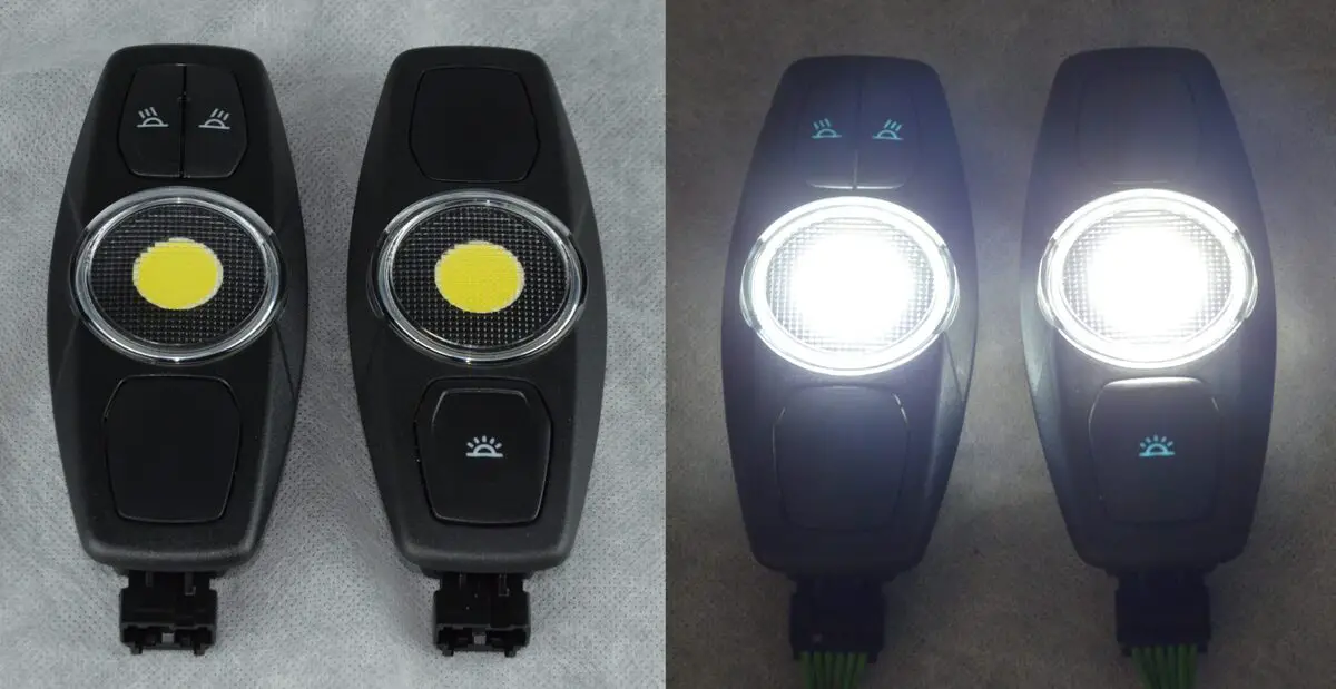

I used a plastic panel removal tool ... there is a clip on one end and extension/plug socket on the other(you can see it in my one photo that has the board, housing and new led). The clip faces forward while the plug/socket face the rear and support the rear of the housing by over haging the ceiling panel.
I put a plastic panel removal tool under the front(clip side) and pried it down slowly but with firm pressure, after the clip cleared the ceiling panel the entire housing will slide forward and out exposing the plug/socket on the rear side. Unplug it and you are good to go.
Removing the led on the board is kinda of a pita. I rigged up a heatgun as a hot air rework gun and almost got it de-soldered... Ultimately I ended up sticking a big chisel tip on my solder iron cranked it up and use electronic flush cutters.

Thanks for mentioning our DriveBright Explorer dome light LED upgrade service. We have done well over 2,000 Explorer dome light LED upgrades over the past 8 years. Our LEDs are incredibly bright and an excellent true white color. Here is a link to all of our interior LED lighting products for the Ford Explorer:

Those 5050 5 SMD LED bulbs are not very bright, especially in magenta color. I can use those magenta LEDs, but I do not think you will be happy with the light output. The blue LED we use is specially made for us, just like the white LED we use. They are extremely bright. There is no additional charge for the blue LED upgrade service. The blue LED upgrade is special order only. Just place the order for the standard LED upgrade service, then send us an email (info@daytimebrightlites.com) or call (913) 304-0720 and let us know you want the blue LED.
