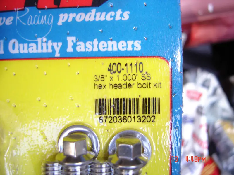

I bought these:

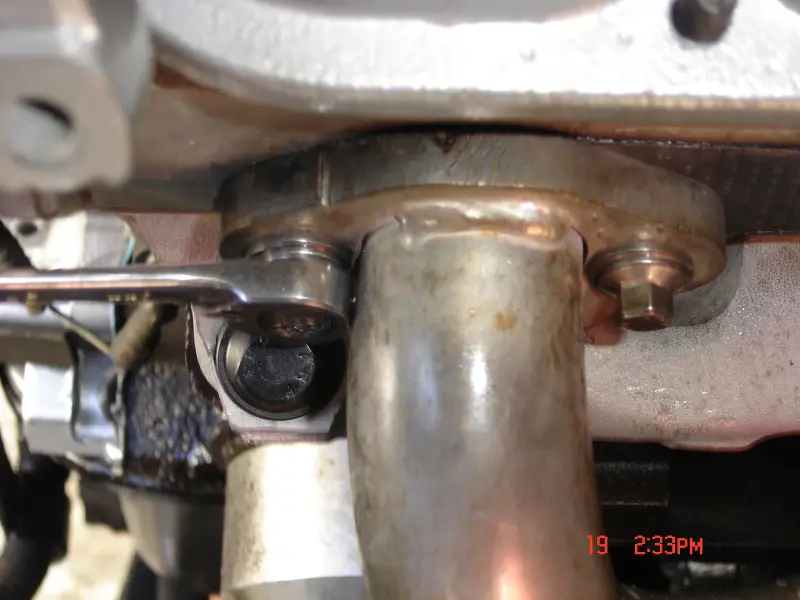

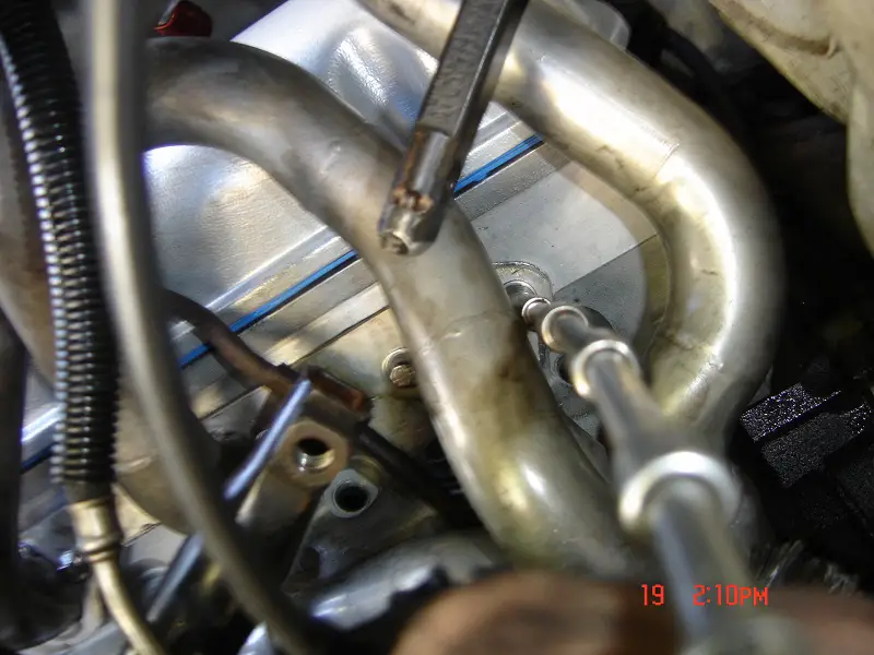

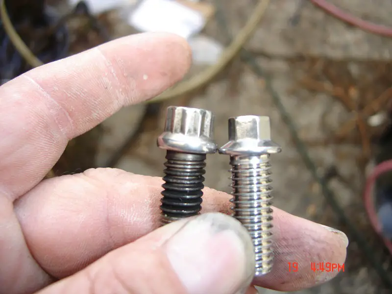

They are from ARP, part number 400-1110. They are a Stainless Steel, 3/8" thread, with a 5/16" 6-pt. head on them. It doesn't seem like a big difference, but it buys you a TON of room when you go to tighten the bolts up.
From Header OFF, to bolted on a torqued...it took about 10 minutes!
Problem SOLVED
Buy them from Jegs for $39.99

*Note, Jegs has the correct picture for the hardware, while Summit Racing uses a generic picture of a standard 3/8" bolt with a 12pt. head...although it does note that the image they are using does not represent the actual part you are buying.

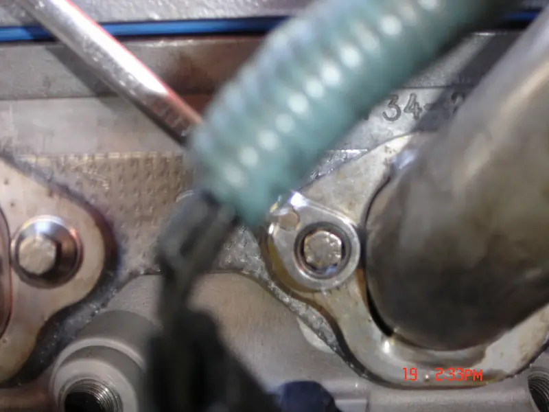

And here is a shot of a socket...YES, a REAL socket!....on THE MOST IMPOSSIBLE bolt to get to...
And if you notice on the previous pictures, those aren't just wrenches....those are RATCHETING WRENCHES....that I fit in there.
