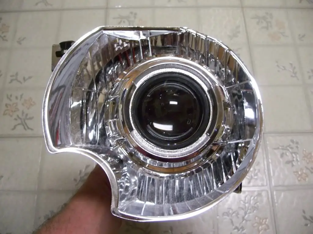

The Explorer's reflector is quite larger, so I don't think that the Mini Gatling Gun or the Mini Graphite quite fill out the space adequately. If you decide to go with the D2S, those 2 shrouds don't fit anyway, so that decision is already made for you.
Another issue that you have to address is the darn turn signal reflector "notch". It protrudes into the main reflector and cuts down on your choices, unless you're willing the hack the shrout a bit or vacuum-form your own (you don't want to go there!). The larger (bottom) dimension of the Gatling Gun is a hair over 4.5", and that is about as large are you want it (check the photos below, and you'll see that it barely clears). The Apollo shroud is a hair over 5" and requires trimming.
Personally, I prefer the Gatling Gun. I think it has the right balance of size and it actually fits. It fits both the D2S and the H1 (with an adapter ring). Sorry for the dusty pics, I just finished trimming the housing for the D2S.

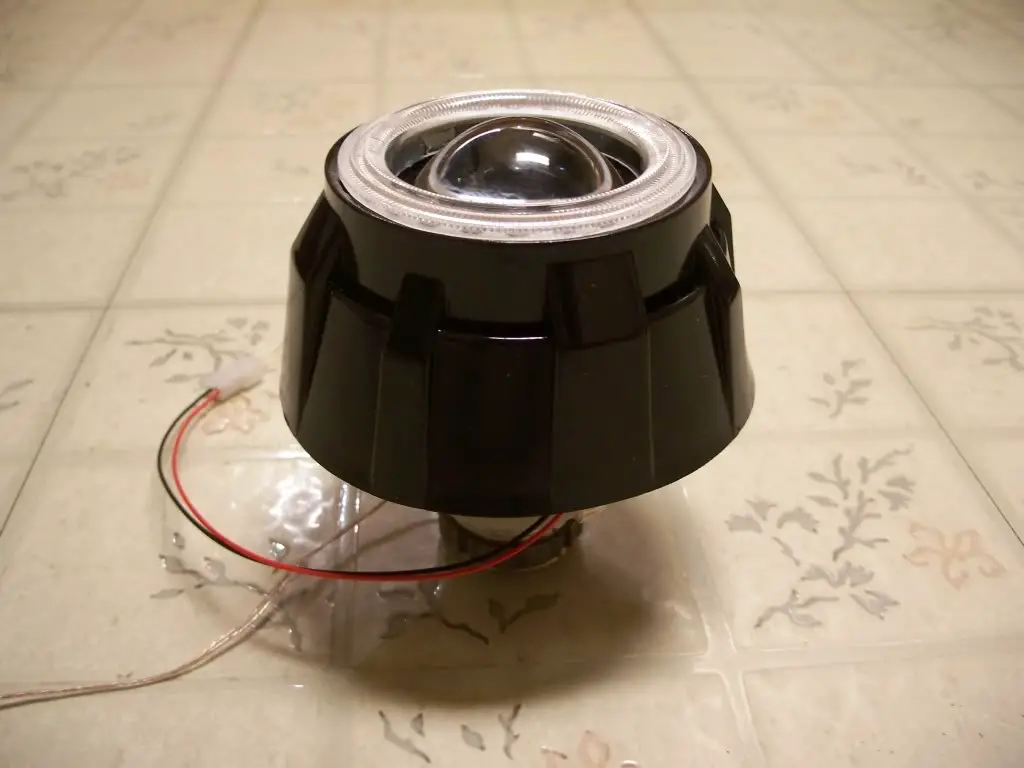

Gatling Gun on D2S (De-chromed, painted and modified with LED ring):
Mini Graphite on H1:

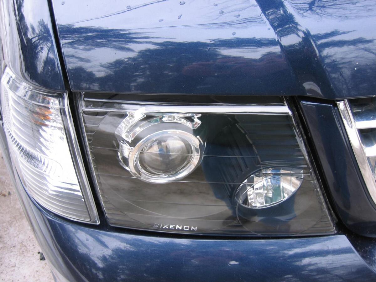

Mini Gatling Gun:

I'm using the original Gatling (I guess it is v1.0), not the v2.0. It think it has a slightly flater front surface, which made it easier to fit the LED ring. I don't have a v2.0 in hand... I used an 80mm ring, the 15-LED version. 60mm, 80mm and 100mm refers to the outer diameter. There is a 54-LED version, but I found it too bright for my taste. It may work for you if you're trying to get the BMW running lights / angel eye look. I did have to trim the outer edge of the plastic difuser to get the combination to sit flush, and to make it easier to glue.

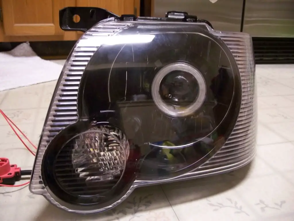

Gen3 Retrofit

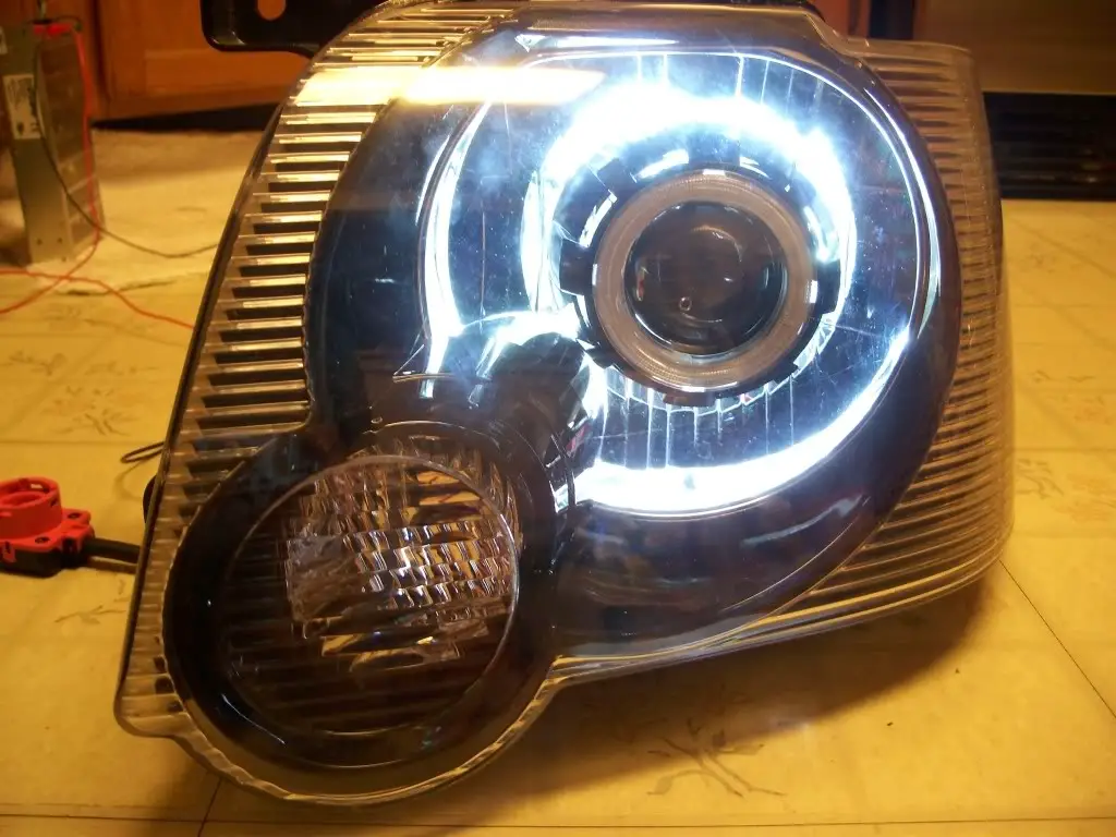

Gatling Shroud with CCFL inside.

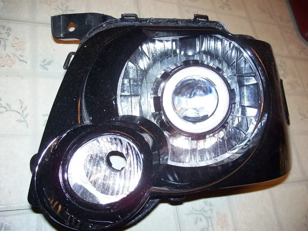

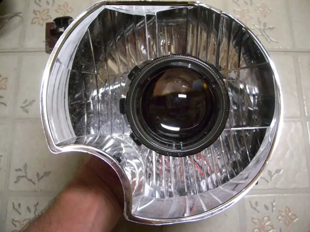

I liked the blacked out look of the modified Gatling so much, I tore into my own Ex today and redid mine to match. I like the way the black of the shroud reflects into the reflector, without being a totally blacked out reflector. Gives it kind of a ghostly look.
I should have pics of the whole thing installed tomorrow, maybe a quick video too, but this is what we're both ending up with:

I should have pics of the whole thing installed tomorrow, maybe a quick video too.

Does your friend's also have dual LED's mounted backwards in the shroud? I'd like to see some pics of those as well if you have them. What type of paint did you use for painting the housing and shroud black?

Unfortunately, I didn't take pictures of the back rings, sorry. Basically, I use 4 small plastic tubes (cut up from dead Bic pens, gotta recycle!) to create a set of stand-offs, and glued those to flat part of the back of the projector. Then 4 thin but sturdy plastic strips (cut up from one of my wife's leftover Tupperware containers, she won't miss it!) to tie together the 100mm and 80mm rings. Then I glued the combined rings to the stand-offs. That's it. If I ever do it again, I'd probably stage the 2 rings rather than tie them together. I thing I'd get a better reflective effect if the 100mm was more recessed. With the 2 rings tied together, the 80mm pushes the assembly forward, since it cannot clear the bowl of the projector.
The only difference between my setup and his setup is that my Ex is black and his is blue. Other than that, he's getting an identical configuration.
As far as paint, I dechromed the shrouds first, using oven cleaner (bleach works too, for more complex or larger pieces). It took a couple of cleaner/rinse cycles, but eventually you end up with this:
Then a couple of thin layers of Rust-Oleum Self Etching Primer, followed by Rust-Oleum High Heat enamel (thin dusting first, then 3 thicker layers). From there, into the oven for 15 minutes or so, on the lowest setting (200F in my case). Last step was Rust-Oleum Clear Enamel, only a couple of layers, to get a more reflective effect. And again in the oven for 30 minutes (oven off, pre-heated to the lowest setting). From what I've gathered, if you're going to do a clear coat, you have to make sure it is the same type as the actual paint, Enamel+Enamel, or Acrylic+Acrylic. Enamel+Acrylic makes for a bad combination.
