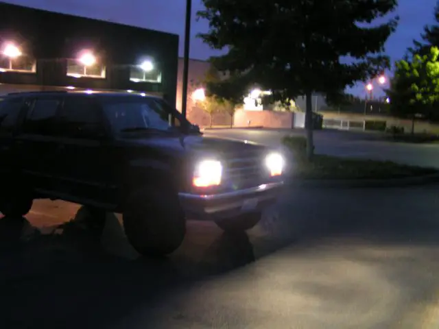

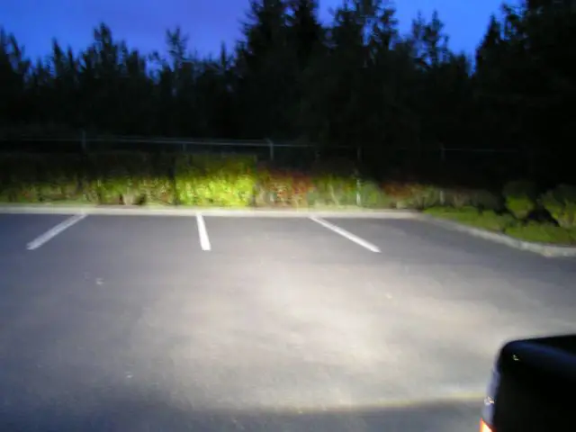

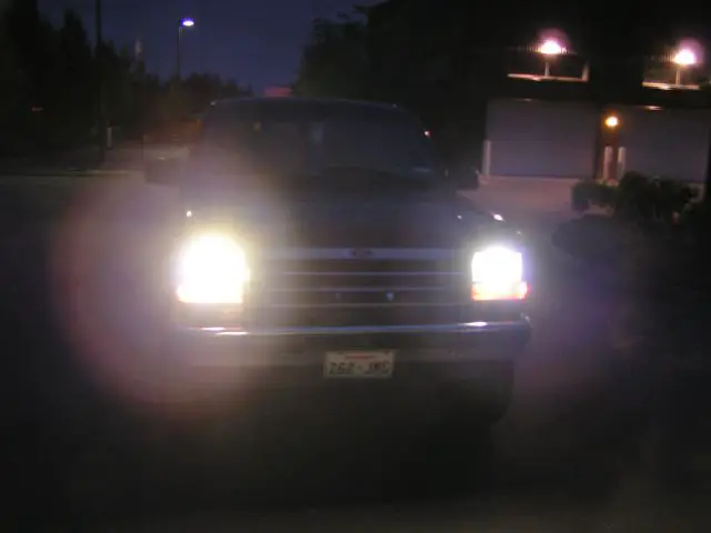

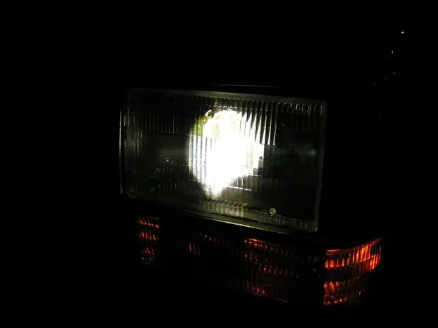

I've got a few pics of my new HID Projectors so far. The camera takes away lots of light as it focuses, so you wouldn't believe what these look like in person. I have a couple low-beam and high-beam pics. I'm VERY happy with these so far!

wow those lights are incredible....how much total was the whole buildup??
Scott
Thanks. Total build-up was almost $600. This entailed retrofit, new headlamps, projectors, and HID kit.
Does it look any different than the factory lights? Would someone walking by your truck in the day time be able to know that you have aftermarket lights?
If they looked real closely they could tell. The inside of the lens is painted black as not to shoot light all over, so that's visible. The projector is hard to see because of the rippled lens.
Do you suppose there might be a way to get a clear, unrippled lens? Or perhaps making some kind of custom thing painted the same color as the truck, so just the projector is showing?
I really like the look of the new Grand Cherokees for example, with the clear lens and projector looking things. I think it'd look better on something with a rounded front, but it could work for a gen1 Explorer...
Sure it's possible. The only thing not painted black is the lens. I suppose you could stencil where the projector will show and also paint around that. I don't want the projectors to be that noticeable because the ease and popularity of them being stolen. You can sand down the ripples in the lenses, or buy the new diamond lenses (for $180 :rolleyes: ). I would've bought the diamonds but they came out a few weeks after I sent my other lamps to get retrofitted. The guy said I could send them back with the diamonds and he would swap the lenses, but I'm happy with them just how they are.
You should change the lens or at least polish it smooth to get rid of the "ripples". Projector shoots light in a predesigned pattern. On your truck that pattern is being screwed-up by the "ripples". They alter the outcoming light pattern.

I was planning on using the diamond clear lenses, but I don't want a clean cutoff. The ripples don't really affect the lighting too much, just ruins the cutoff. And these are bi-xenon, so highs and lows.

are those hi-beams in your pictures?
Dre said:
the cut-off is what makes it unique... set-up of a projector within a regular headlight does not make sense.
Yes, the second picture is high. Why doesn't it make sense? I get better light output. The cut-off is just a decoration for the ricers. I'd rather have my light spread.
