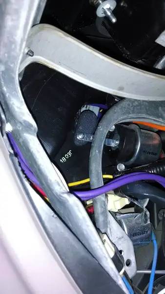

I recently fixed a problem similar to this. If memory serves one of your actuators isn't functioning in the dash.
Empty then lower your glove box. Crouched beside the truck looking up thru the open glove box toward the center of the truck you'll see several small silver vacuum actuators. I think the linkage on one of yours is broken...
I recently put a new 'lever arm' on mine with lots of plastic welder epoxy.
This is NOT a fun place to work, I hope you have small hands.
I'll try to post a picture.

You're looking at the linkage on the actuator in the center of the photo.
Here's you'll see the new actuator arm that I 3d printed and glued on... (has kinda a cross-hatch pattern facing the camera)
