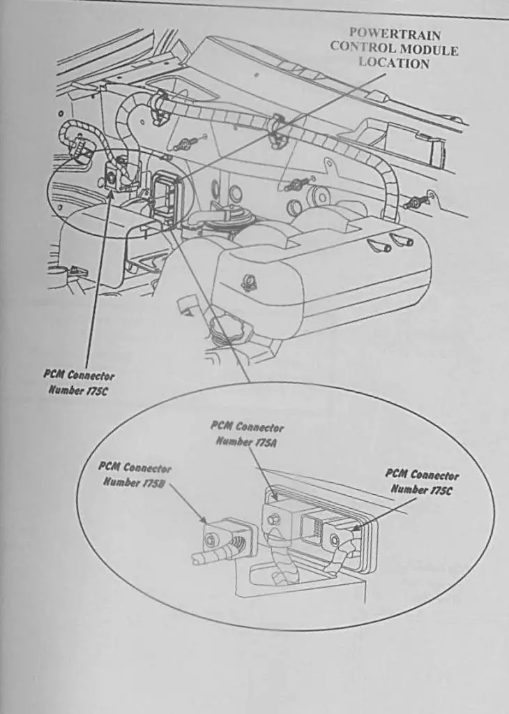

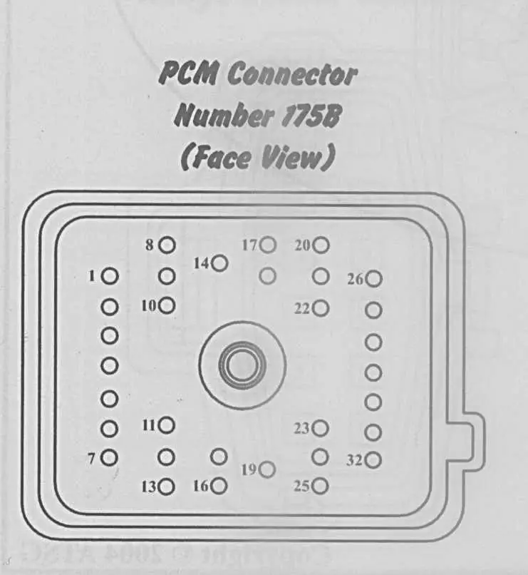

Hobbitak, I am in the midst of diagnosing my Solenoid in my 5R55S tranny (2005 Explorer). The links I have seen or been given show a diagram that looks NOTHING like my cable when I pull it from the PCM. Could you please post the 5R55S solenoid diagnostic prodcedures/pics as well?
My Servo Bore repair didn't fix my symptoms...so, I found a new Solenoid Block on eBay that I will add in a couple weeks. Just wanted to diagnose my existing block before I violated this new block with MERCON V.

Here are the resistance check and PCM location information....sorry it took me so long.
hobbitak, thanks, but I don't see anything but your words. No pics or links.
