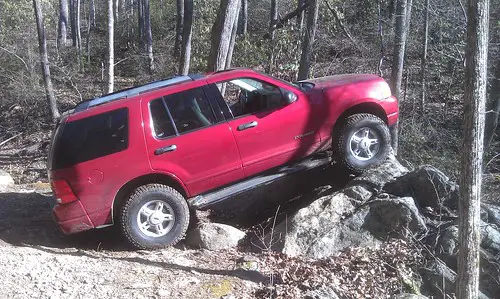

heres KOVALCHUK's 2005 stock explorer
265/75r16 BFG Mud Terrain. not sure if he had to trim or not
This is exactly what I'm looking to do. Is this with a 1.5'' lift or just straight stock? Thanks for the help guys.
looks stock imo

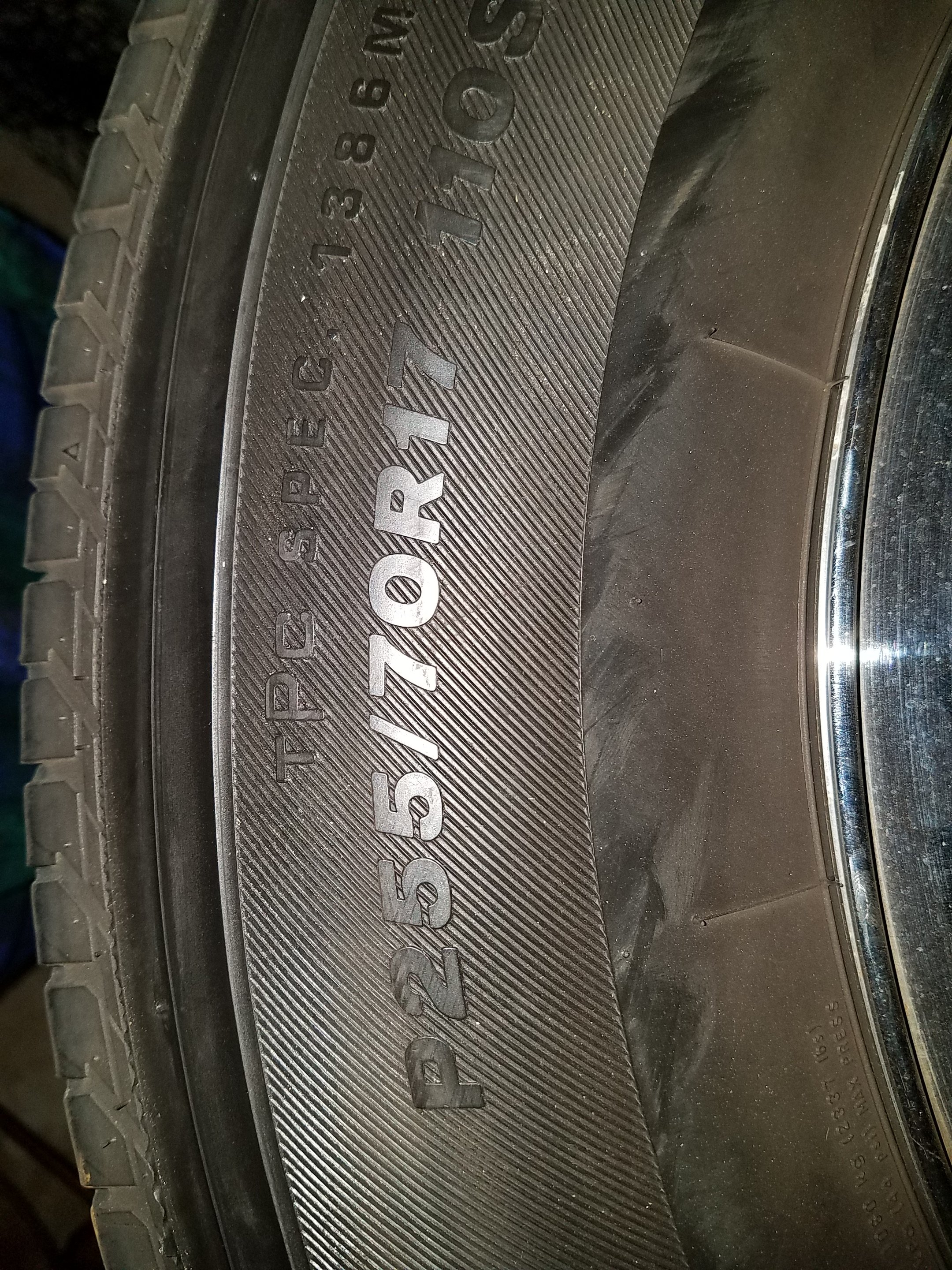

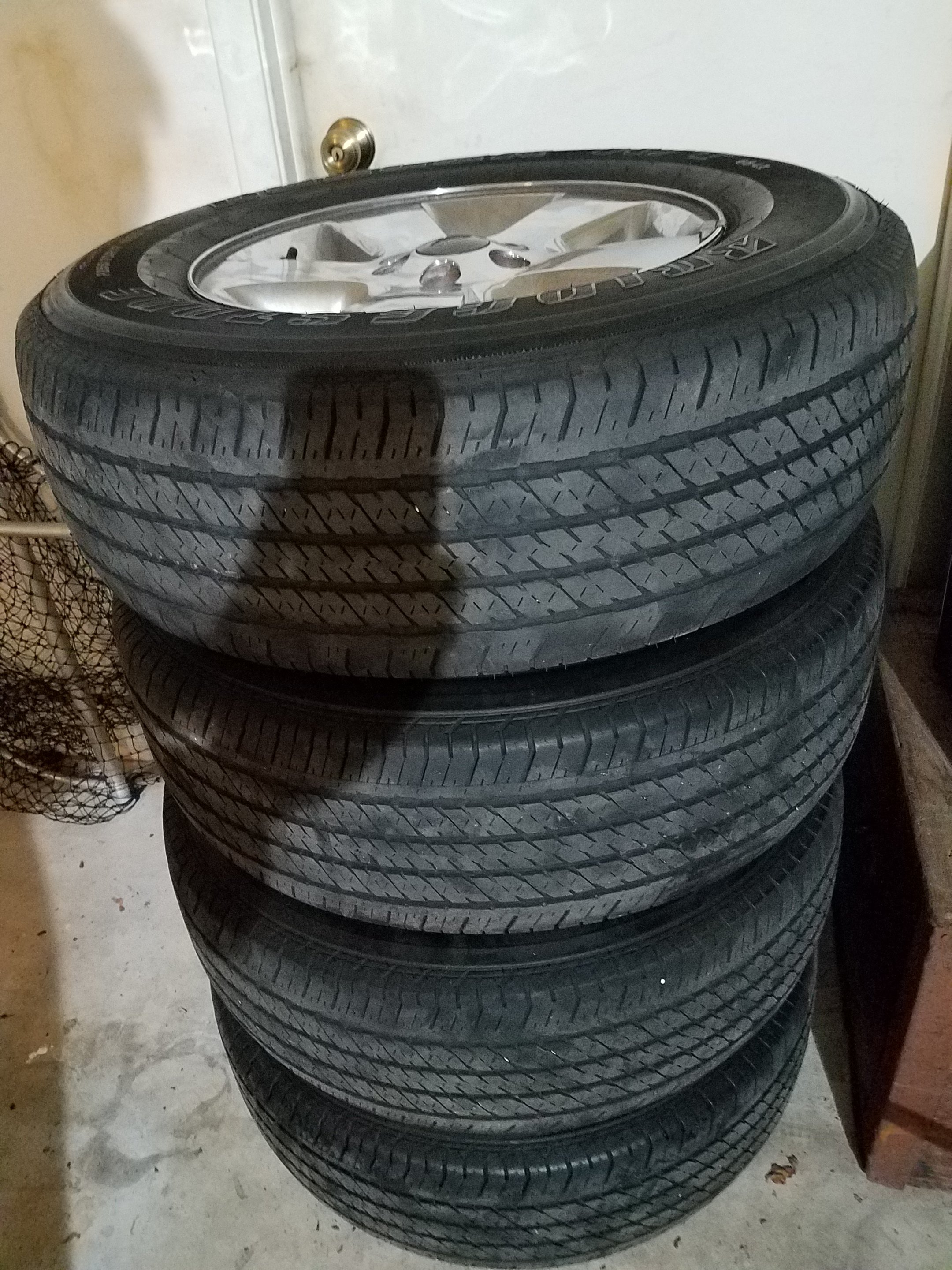

I was running 255/70 17 on my 2005 limited. I have since taken off the truck if anyone is interested in the wheels with tires, they are in central florida.....Bridgestone HT Duelers. No rubbing on stock height. Hunter balanced and ready to put on.
