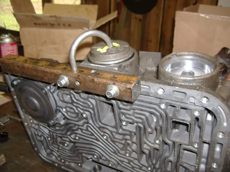

This one I made with a scrap of 1" tubing, and a muffler clamp. Also 2 bolts matching threads of the pan, but a little longer.

don't know why drdoom but i just get the red X for your picture
dakotablu is offline   Reply With Quote

drdoom - got the pictures - thx
do you just tighten the muffler clamp nut to compress?
I'm under the vehicle now and I can't get the cover to compress - I'm guessing that the piston might be cocked just enough that the cover won't re-aline. I can probably cut a 2X4 and put more pressure on it but I wondering if I'll damage the piston bore. I haven't tried to remove the cover but the lock ring came completely off while I was trying to compress. what do you think?

Dakota, yes, I just tightened the nut on the muffler clamp (cut into a "J" hook) to compress...shouldn't take much pressure. But consider the following: As you know, there is a servo behind the cover. The servo pushes against the APPLY LEVER, which in turn pushes against the APPLY STRUT, which then applies pressure to the band.
You probably already know all of this, so forgive me if I am re-stating the obvious, but be mindful that you are aligning & compressing several things at once. Now I am not saying that you should be using a proportionate amount of force, but just have a good picture in your mind of exactly what you are trying to do.
The servo spring is not that large, so if it's not going in, stop and take a breather. If everything is clean, very little force should be necessary. Backing off the anchor strut (band adjustment) a bit will help get the servo cover back in. In fact, you should always loosen the anchor struts before compressing the servo covers. But be careful, it's one of those things that if you loosen it too much, the strut(s) could drop into the internal area of the transmission, requiring a tear-down to correct. After you button it back up, re-adjust your band(s).

A large welding C clamp shaped Vice Grip could push the cover back as well. The valve body applies fluid to push the servo against the band. Do you have a flashing O/D light? FMEM or limp mode causes excessive EPC pressure which might cause this to happen if the servo retainer is either bent or old. Spring metal in a small diameter could move as temperature changes. Think about this senario. You're driving for a while with hot transmission fluid, then you suddenly go over a large puddle or a snow bank. Some cold snow or water hits a weak retainer while there is a demand by the valve body to apply the band. The servo engages, and pushes a lot of pressure against the cover which causes the retainer to lose its ability to stay in place.
I have a thread on home made tools. Drdoom, could you add your servo compressor to that thread? It's # 63 in my list of useful threads: http://www.explorerforum.com/forums/...d.php?t=195437

Brooklyn Bay, I'll will dig my tool out, get some measurements & photos, and happily add it to your thread.

Thanks for adding the information to the tools thread. It looks like it would be easy to make a dual servo cover compressor with a longer bar.
