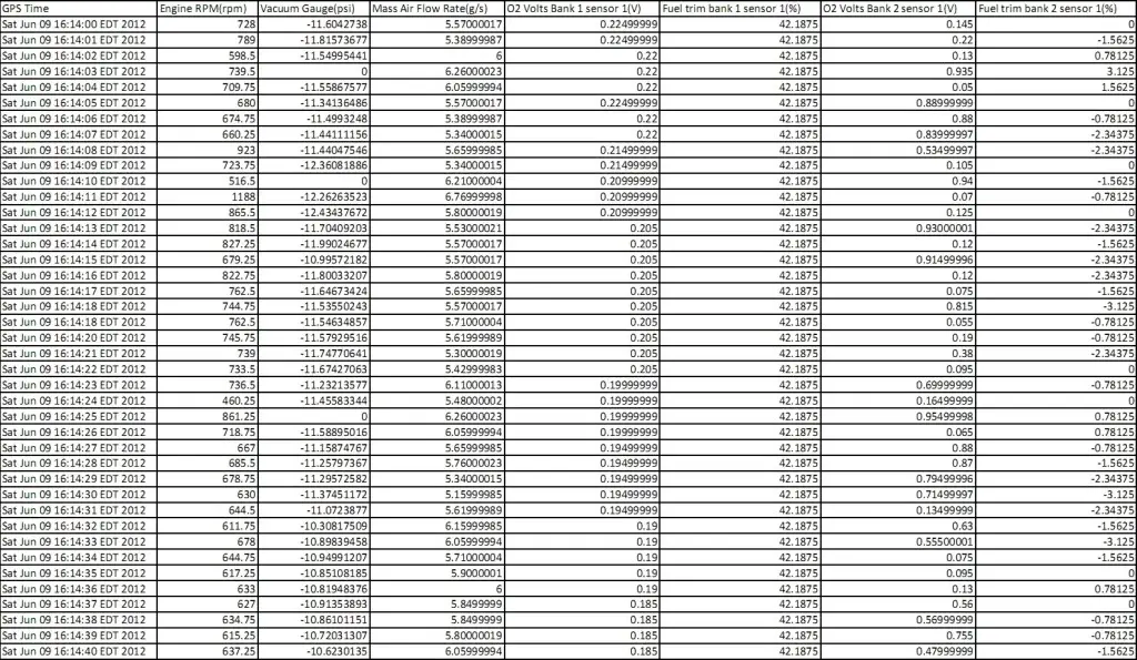

I have my new code reader and it reads some pretty detailed stuff using Torque on my droid phone. I recorded some of the data when I started having the idling issue. A little past half down the pic, my idle drops to 460. The voltage to Bank 1 Sensor 1 is at 0.19 where Bank 2 Sensor 1 is above 0.5 almost the entire time. Does that mean the sensor isn't working? Also there is a few times when the Vacuum reads 0, I don't know if this is really a loss of vacuum or a glitch in the program or lag. And lastly, the fuel trim is solid the entire time on Bank 1 with a postive number, where as on Bank 2 it is always changing and a negative number. Can anyone make sense of this info:
