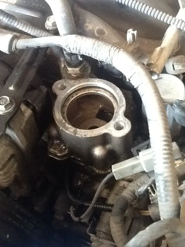

Changed the thermostat last night and found this:
You can see corrosion/leakage under the thermostat housing, which explains the previous coolant loss. Trying to be proactive, I got a new thermostat and changed it last night. When I pulled off the top cap to change the thermostat I saw no evidence of leaking. It looks like it is coming from the underside of this housing, but I didn't want to tear into all of it without knowing what I was getting into.
What is the u-shaped aluminum housing that runs behind the alternator and over toward the coolant bottle? It appears that all of this is the same piece with leaking thermostat housing. Anyone had this apart before to where they can help out?

So here what the housing looks like:
Empty, I tried to clean it up the best I could but the discoloration wouldn't completely go away:

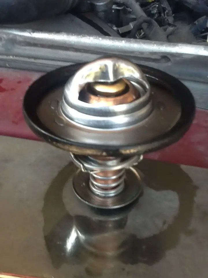

New thermostat involved:
New thermostat with rubber seal on top of it:
Here's the new thermostat and the old seal, stacked as installed:
Here's just the old seal:
It is not in brand new condition but the O'Reilly parts store near my house didn't have a listing for the rubber seal-their computer thinks it is a traditional gasket (which it is not) so I'm stuck using the old one on limited transportation.
I'll replace this seal when I can but I really don't think it is my issue.
Also, the question I was asking about was the u-shaped aluminum housing-one end is the thermostat housing and the other end is what the coolant bottle feeds in to. It is not a plastic piece: it is part of the cooling system.

1. The u-shaped part I was referring to is actually the entire upper intake. I would have to replace it for $410 at the stealership for just the part alone. Don't even want to speculate on how long it would take.\

If you are referring to green stuff as green coolant, it is actually suppossed to be gold coolant not green. Gold is considered long life where green is not. I would not be suprised if was the intake. They have had issue's with the plastic intakes.
my 02 was leaking in the same spot as yours, right under the t-stat i was slowly losing coolant. i replaced the upper intake, i think it was just over $200 you should be able to do it in a few hours

Guys the overheating issue is solved. For whatever reason, the new thermostat was causing the overheat. Replacing with the OEM stopped the overheat. Took the replacement thermostat back.
