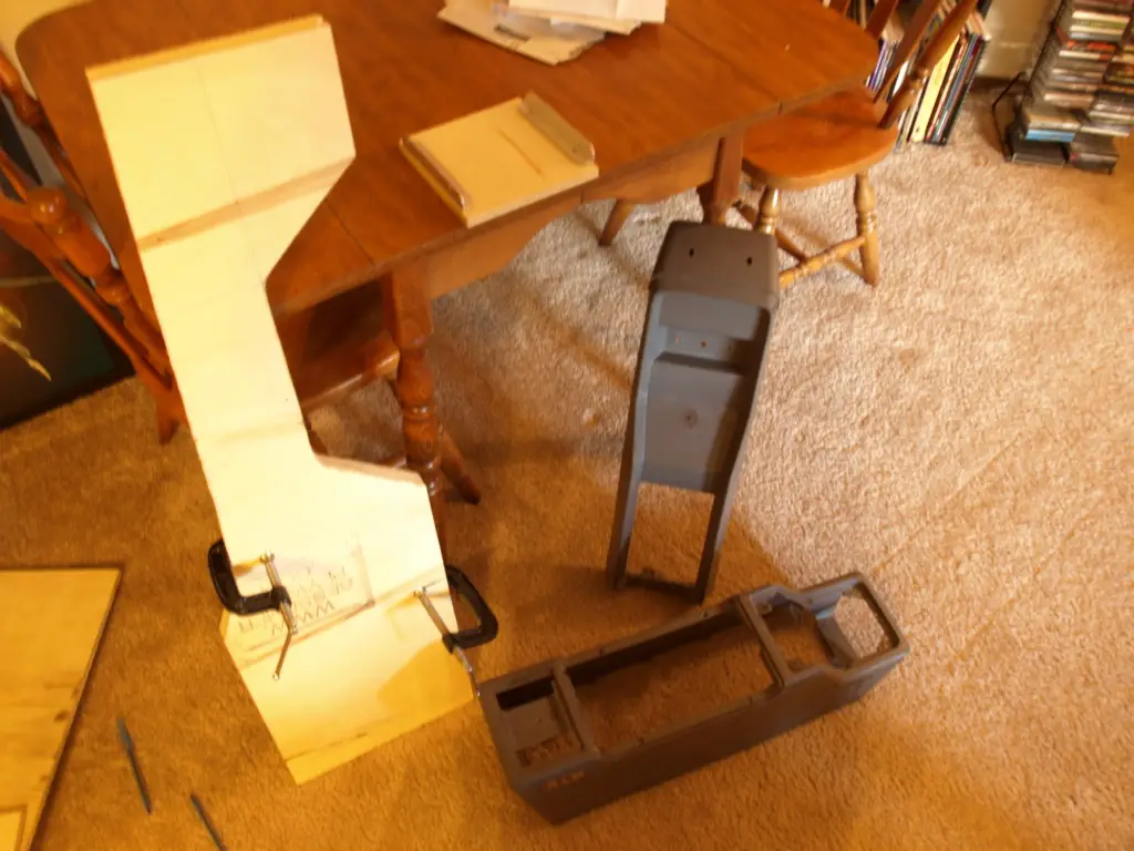

Hey guys like the title states, I building a new center console for my ex. Ive already pulled the current one and am using it as a template. I want it to extend all the way to the under dash and come up slightly over it to mount a tablet pc. I plan on using the existing floor mounts. It will be covered partially in auto carpet and leather upholstery and house the LED(not that crap in little coffee can racer hondas but nice under seat illumination) lighting junction that I plan on through out the ex.

This is before a test fit, I new I was gonna be close with my guestimate.
This is after the test fit.

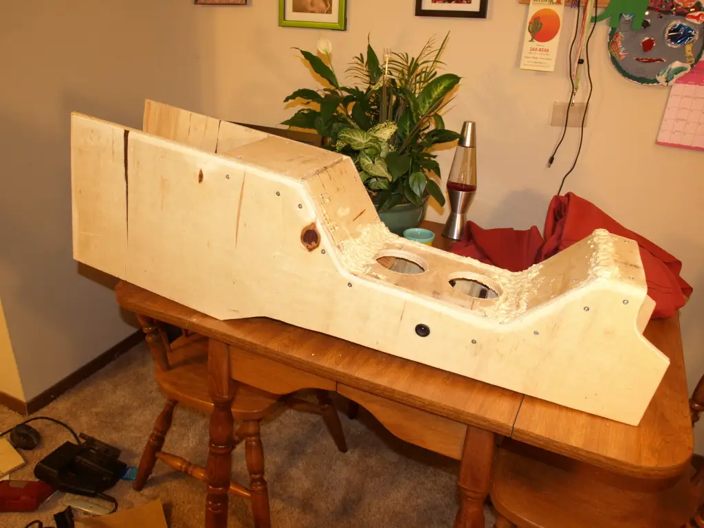

And this is a view of the under seat lighting switch, one on each side, as well as great stuff foam, to fill the gaps between the cuts because there just 90 degree angles so nothing butts up perfectly. Once its fully cured it will be sanded.

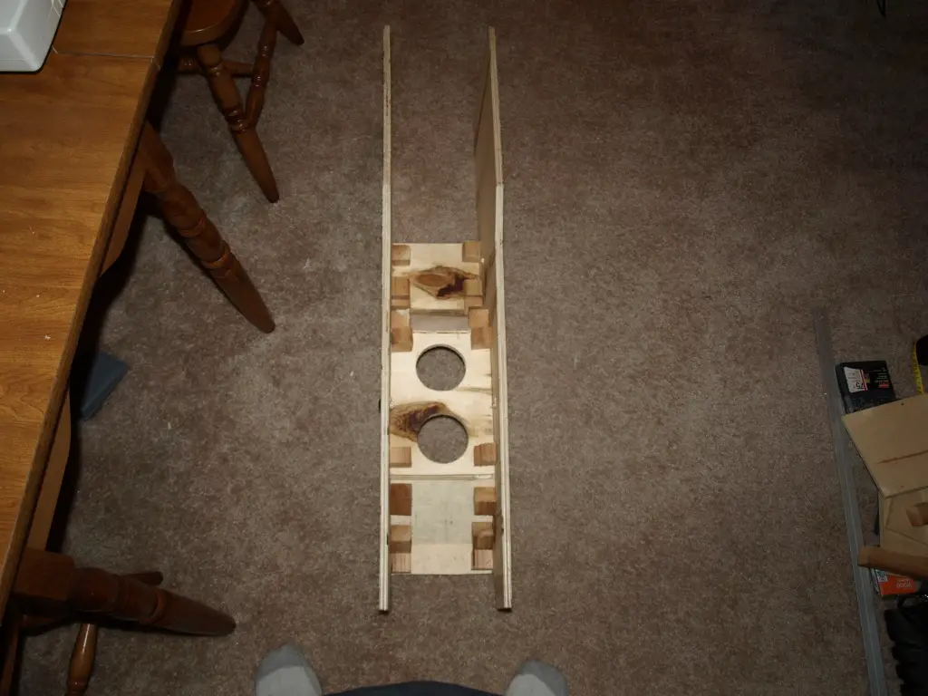

This is the how the general structure is built.
Now I just have to figure out the cargo compartment, and the arm wrest.

Ok so here's a pic of the foam rough sanded down, the lighting in my apartment is great so the picture is not what it could be. But remember there is going to be a fabric batting and then the upholstrey, so getting everything perfectly smooth, but doesnt mean I wont try.
Ill get a better picture later.

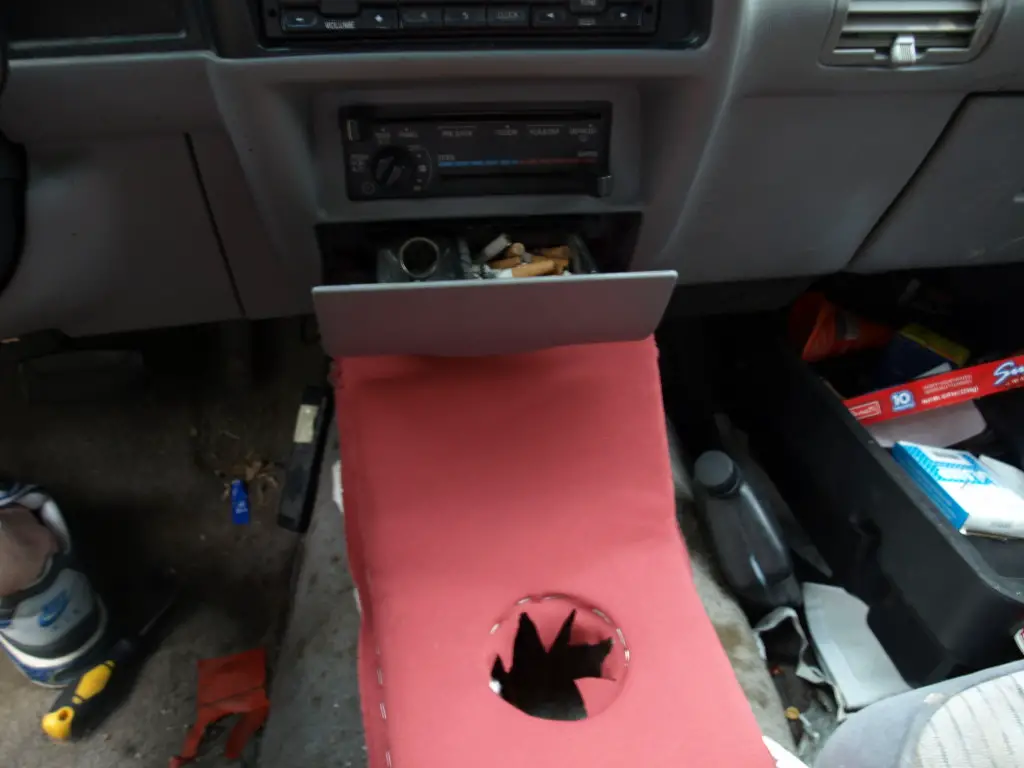

I didnt realize that I made it a finger width to high until I went to pull the ashtray.
I had to move the console back to get my fingers in to pull out the ashtray, it slides in and out no problem once its out far enough to get my finger in there.

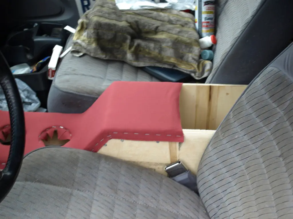

Well staple gun shows pretty decent results not what I really wanted but not bad.
