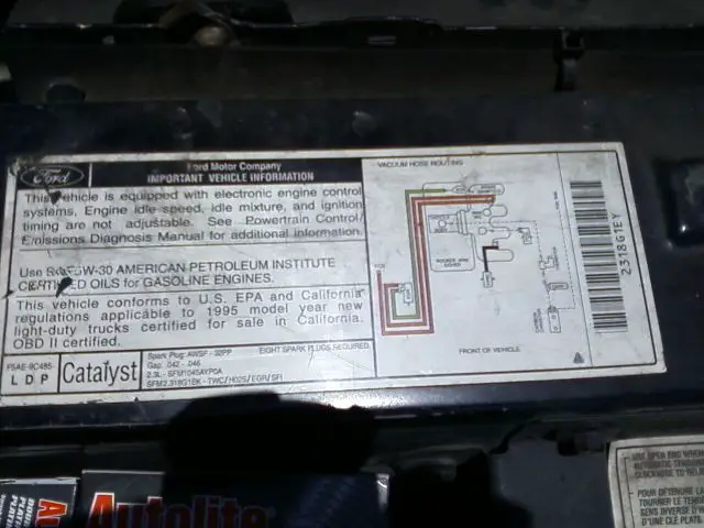

..Before you run out to get plugs and wires, find out what plugs you do need for your vehicle..Most all of this information can be found under the hood within stickers that are placed on your radiator core support..;)
..This information is particular to your individual vehicle and will save you from getting general information from your parts dealers..

Enlarged view of the vehicle information..
Enlarged view of the plug information.
This is where you find what type of plug and it's gap..
..and as a Bonus I'm including the 2.3L serpentine belt with A/C diagram..
..You will notice the following information of the enlarged view of the plug information that it calls for:
Spark Plug - AWSF-32PP
Gap - .042-.046
When using the Autolite Competitor Cross reference for these, this is what comes up..It shows the original part number to be a Motorcraft plug and their options to that plug..

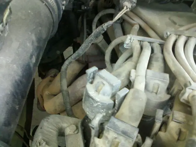

Passenger side
..This is the passenger side aka, the easy side..
It becomes a lot easier to reach these four plugs and you gain a lot more room to work as soon as you remove the intake tube and breather tube..:biggthump
..Starting from the front to the rear I count the plugs 1-4...I start at the front (1) and work my way to the back (4) on the passenger side swapping plugs and at the same time swapping in the appropriate (matching length) wire to the coil pack..This side wires all go to the rear coil pack..
..I only needed the 3 or the six inch extensions on this side..The only thing on this side you have to be careful of working around is the EGR and it's electrical and vacuum connections by #4 plug.

Drivers side
...Make sure you have your extensions, swivel, string, needle-nose pliers at your ready..:hammer:
..On this truck (with the A/C) it is very hard to reach in to pull the plug boot even if you have a pair of long handled spark plug boot pullers..That is why I did not mention it on the tools list...This is where the small rope gets used..
Note:.. The actual cylinder you may need to use this slip knot on may vary due to others relocating different wires in different locations when previously changing these plugs..
..Make a slip knot around the spark plug boot (not the wire) and easily pull the boot straight off..
Note:..Extra care should be used on this side when removing the plugs themself as in other electrical and vacuum lines in this area...Extra care also need to be taken when re-installing the plugs..."Finger start" each plug carefully as they are tapered nd the holes are at an angle..
..Now using one of these setups, 6" and 3" extensions and swivel or the 9" with swivel or...Well here are some ideas on configurations needed to pull these 4 driver side plugs out..The swivel seems to only be needed on 1 and 4..
