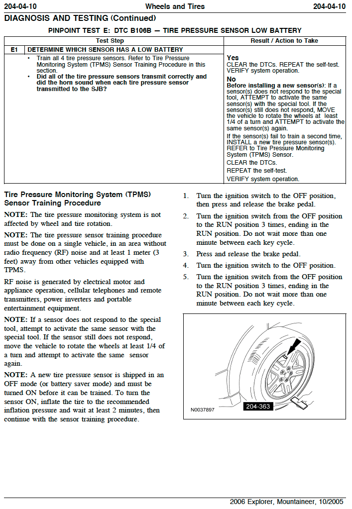

When a new wheel sensor is installed (Ford has several models that are not interchangeable) then its ID must be updated to the SJB by a training process. The training process requires a tire pressure monitor activation tool (readily available for about $30) and all 4 wheels must be "trained" in sequence (LF, RF, RR, LR) in a time sensitive procedure away from other TPMS cars or consumer electronics. I can give you the procedure but Ornery can do it better.

Awesome, thanks! I just ordered the little trainer thingy. I'll let you all know how it goes.

So tonight, off a whim, I decide I'm going to try something. I'm going to take the band sensors and place them on top of each wheel, and then go through the process of programming. What could it hurt, right. Well guess what? Did the programming thing, pushed the little button next the the band sensor on top of the front left wheel and........TOOT! What!?!?!?! Could this actually be working!?!?!?!? Go to the next tire....push button.......TOOT!!!!! and then the next two!!!! TOOT!!!! TOOT!!!!!! What is that?!?! What does it say on the information center?!?!?! TPMS Programming Complete!!!??? Yeah it's telling me I have low pressure (Of Course!!) but it works!!!!
