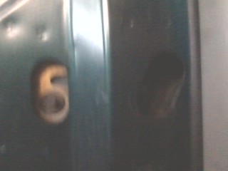

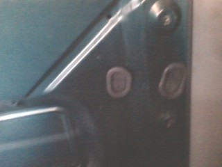

For anyone that is reading about this, I forgot to mention that you must remove the door panel and window trim. and then you will see two black oval shaped rubber plugs toward the rear center of the door. the door must be fully closed, once the door panel, window trim and rubber plugs are removed the bolts are visiable through the access holes. either I am not explaining this right or some people need a visual aid. I will try to get some pics and post them.
hinge bolt access holes
One picture shows the rubber caps over the access holes, the other picture shows the bolts after the caps are removed.

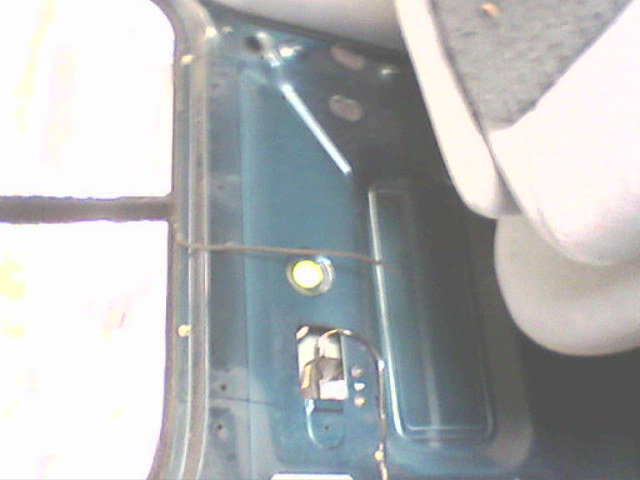

OK since I don't have a digital camera, and I am stuck using my phone to take the pics, I will post one more in a day or so.
inside of sliding door.
Ok here is the inside of the sliding door. Sorry, the picture came out sideways. the top of the picture is actually the rear of the door.
