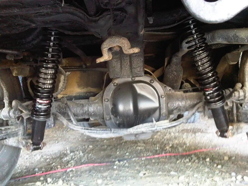

monroe load adjusters in the rear will give u some additional lift and Rancho 5000s up front same set up 98 Sport the load adjusters gave me an additional 1.5 inches in the rear

the Ranchos wont give u any additional lift on the front they will just improve the ride, the Monroe sensatrac load adjusters will give u an additional inch to inch and a half lift in the rear and improve the ride

They are referring to load adjusting spring assisted shocks, NOT "regular
plain old shocks". Search Monroe 58617 (Rear only). Here's just one thread.

i had a freshly built 4 dr leaf pack in my Sport with a long AAl saggy ass syndrome wasnt an issue for me, i had to literaly jack up the truck and the load adjusters to get them to bolt in they are that much longer and beefier than standard shocks i achieved 1.5 inches additional lift just with the load adjusters
