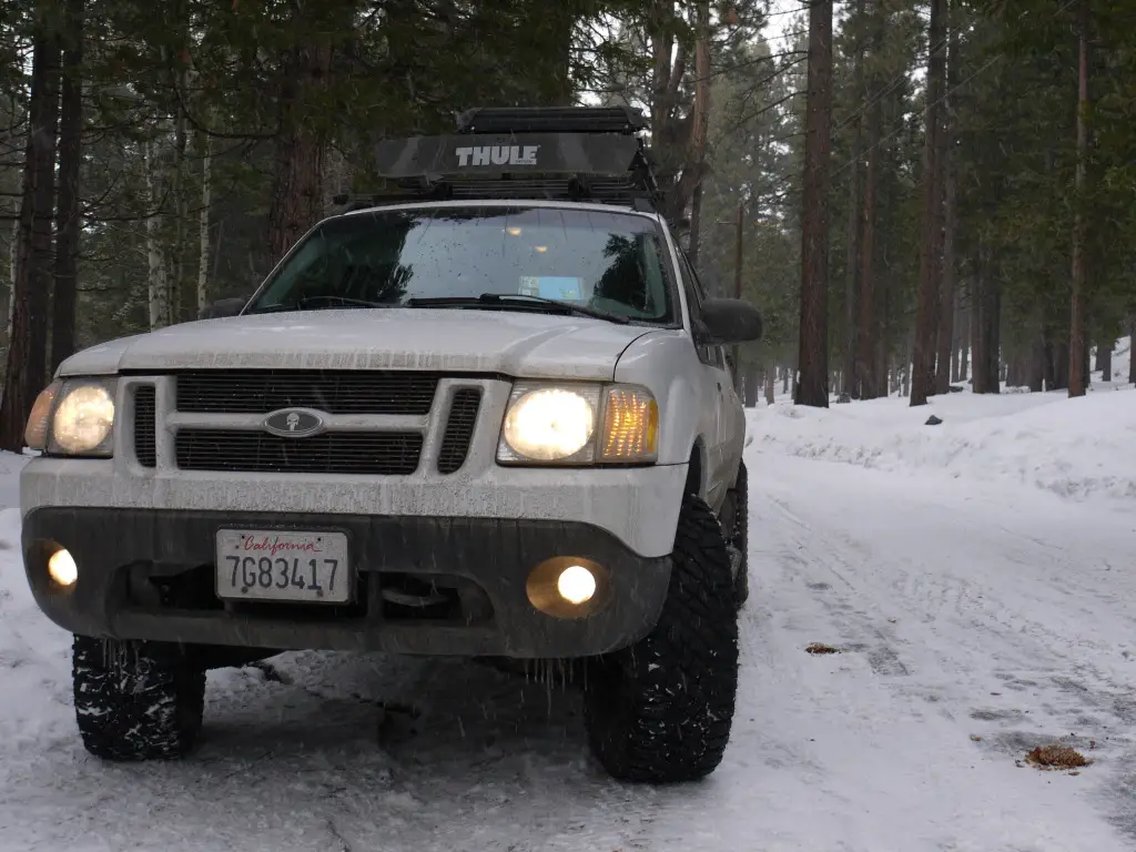

Has anyone installed tow hooks? I see plenty of ST owners with bumper/grill guards. Is there a way to install them tow hooks?

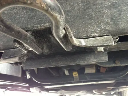

here's mine missing a tooth (bent the stamp weld gettign pulled out of a jam)
Shackles instead of hooks

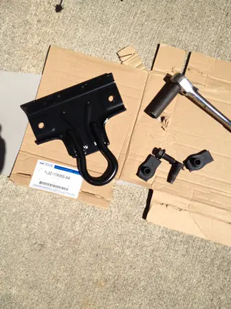

For 2nd gen ST '07-10 this is whats used. This is the same thing for all 3rd and 4th Gen Ex/mounty. It also fit on my '04 but i went with the two frame mounts. This one mounts to the big lower cross member. Export usually got them. Was about 60 or so from the dealer. It will pull out out of mud but i wouldn't want to hoist the whole truck with it.

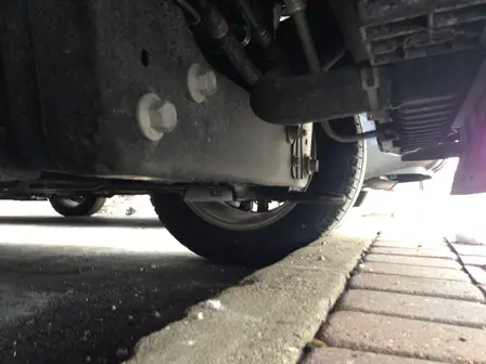

Ronin - Hard to see in these pictures, but mine are just welded to either side of the overall assembly:
mounted on Mounty. Sort of makes a good 'Curb' feeler.

To bring this one back from the dead, does anyone have the part numbers for the bolts and those clip nuts? I can't find them in the parts diagrams online.
Digging through old records, I found these part numbers that I think are for this:
W500642S436 SCREW M12X30 HEX FLN
W520815S436 NUT
