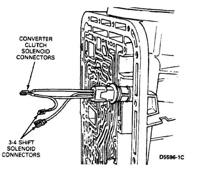

You could connect a test light to the output of the computer, and monitor the lock up of the TCC while driving. The output of the computer completes the ground connection. The three prong connector has a common 12 volt (+) connection for the TCC & 3-4 shift solenoids.

OK. I am now ready to attack this problem. I bought six A4LDs Friday and tore two of them apart today. Now I just need to know which solenoid is the lockup solenoid, front with red wires, or rear with blue wires.
Once I know that I will make an intermediate wire assembly with switches to insert between the transmission and the wires that connect to the transmission. After installing it I will drive for a few days manually working the solenoids to determine exactly what is happening and when.
