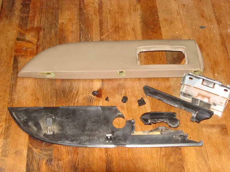

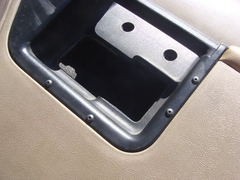

Over time the plastic skeleton inside the door panel arm rests break down and become loose or even fall off. I recently had this happen and it wasn't the first time. Before, I had just got another used one from the junkyard as new ones are no longer available. This time I decided to make my own.

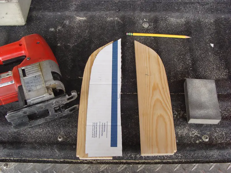

Remove what is left of the arm rest from the door panel. Place a piece of cardboard on the panel and trace the shape the arm rest needs to be to match the door.

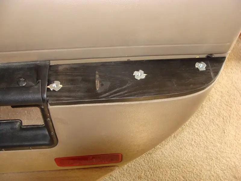

Transfer the template shape to the piece of wood and cut it out with a jig saw. Give it a light sand and slightly round any sharp corners and edges. At this point I chose to spray paint my piece of wood black which is entirely optional.

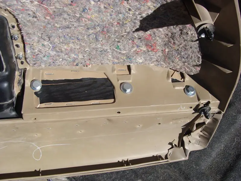

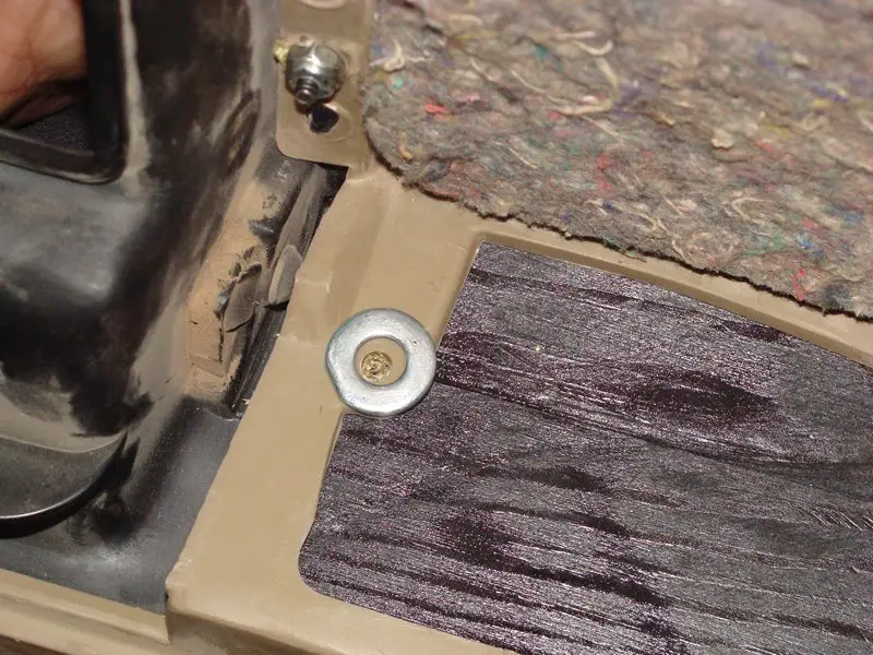

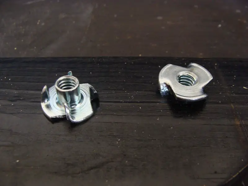

Hold the piece of wood in place and drill from the backside 3 holes that will be used to bolt it on to the panel. Consider the room needed to fit the washers. Drill the holes 1/4" or slightly larger to fit the bolts. Finish drilling the holes in the wood to the diameter needed to fit the barrels of the tee nuts, usually 5/16" to 3/8". On a solid surface hammer the tee nuts into the wood being careful not to split it. The flange will be pointed up once installed.

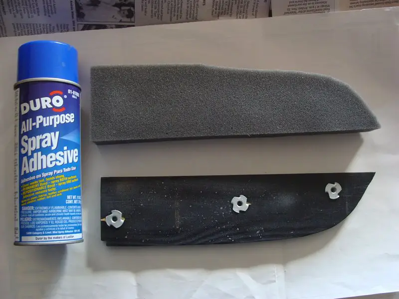

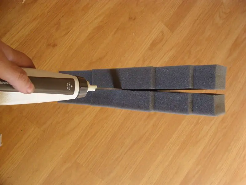

Find some foam that is suitable for the cushioning. I got this block from some packing material I received in a recent shipment. Depending on the density of your foam, cut it to the appropriate height to closely match the stock arm rest. In this case I cut mine to 1" thick since it compressed down. An electric kitchen knife worked very well to cut the foam but a good pair of scissors or other knife should also do the trick. Lastly, cut the foam to the shape of your arm rest, a slight amount of overlap is fine if your foam is compressible.
Spray 1 side of the foam and the wood, wait till it is tacky then join the 2 together and wait for it to cure. This will keep the foam in place while you wrap the vinyl around.

Bolt it on using some blue thread locker and then reinstall your door panel. Not quite as good as the factory fit but this arm rest is much softer and should hold up for a long time!
