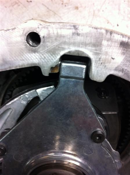

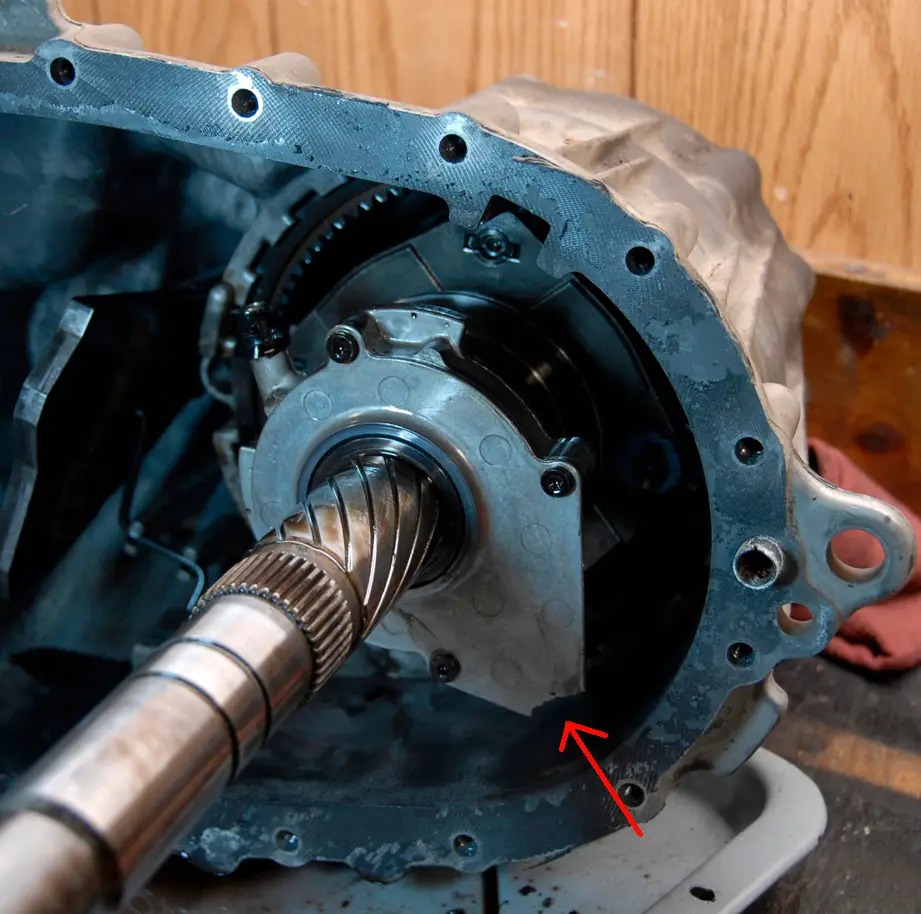

2 years ago i did this swap when i did a 5L swap in my sport. i found all the parts i needed at work (scrap yard that also shreds cars). i took everything apart just to do a once over. i found that where the oil pump locks its self into the case was broken. because of that happening, it allowed the oil pump to spin causing the pick up to snap free and not allowing the case to get any oil (end result all bearing burnt out, oil pump seized, not going into 4x4, you get the picture).
i took it to a local welding shop to get them to fix it. they came back and told me that the case was made from magnesium, and they couldnt weld it, but they epoxied it. me not knowing any better at the time told them to go ahead with the repair. after that i replaced anything that needed, had a friend re assemble the case, put it in the truck. all is well.
forward to now, i am helping a fellow member do the same BW4406 swap to his limited AWD explorer, and also found another case and necessary parts at work and told him we were going to look the case over as well.
when we where just about ready to put everything back together, we noticed the same problem (his wasnt broken free, but close).
turns out, this is a common problem that not even my buddy that was doing the overhaul knew (and used to be a shop foreman at a local ford dealer for years).
what happens is even under normal driving, the oil pump will rock in the case allowing it to bang a grove into it over time. granted, the mileage in both my case and this one is not known, but this will happen faster depending how much abuse, or power is put threw the case.
after calling another friend that owns his own trans shop, i found a repair sleeve for it. for what you get, it isnt a cheap repair, however its less then finding someone that can weld the case, and even cheaper then having to rip the case back out, and rebuilding it.
even though its says 4405, it will work for a 4406.
you will need to grind some of the case for the sleeve to fit, as well as the top of the pump.
and this kiddies is why i tare down any parts that i get used
hopefully this saves some of you in the future.

im not offended at all by you posting that. all i was saying is that some places can weld them, some cant. all the places around my area (and where i work, we have tons of welder contractors coming and going, industrial at that) cant weld it, and couldnt think of anyone that did.
also, you dont know, they might charge $100 a hour, and if it takes 1.5 hours to weld it, the sleeve is still a cheaper way to go.
Dang it I wish I new such a part existed. I bought a BW4406 out of a 97 F150 w/ 130K on it. After I got it home, I come to find the 4x4 didn't work. So I take it apart and sure enough, same problem as you. Oil pump tab broke off causing the pump to seize up on the mainshaft. Got it off and had a machine shop turn the mainshaft down. Got a used oil pump off ebay and stuck it back on without sticking a sleeve in it. Hope it lasts a while. I'm not looking forward to removing the tcase anytime soon....
I actually think what happened to mine was the case leaked, the oil became low, locked the pump up on the mainshaft, then broke the tab off the pump. When I cracked the case open, there was very, very little ATF in there, and it was **** brown in color.....
