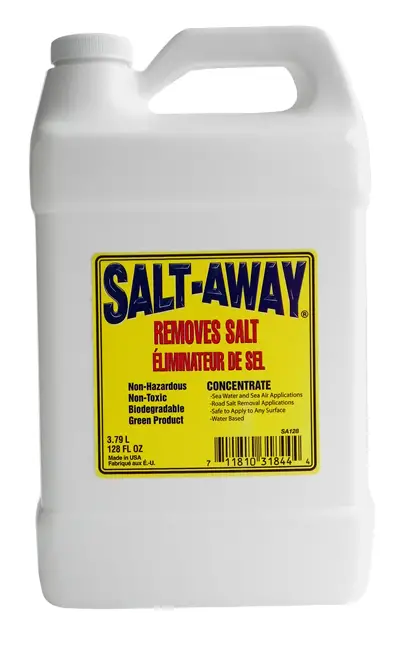

Looks like that radius arm was soaking in salt water for ten years straight!
Yeah...thank you Ohio DOT for heavily laying salt on the roads every winter, and thank you dad for never washing the thing! :thumbsup:........:roll:
Use it! Or else!
:splat:
Hmm.....where would I find that? I've never seen it before, but I don't think I'll need it for a while now that I'm living in AZ, but it'd be good to have when I go back!! :thumbsup:
