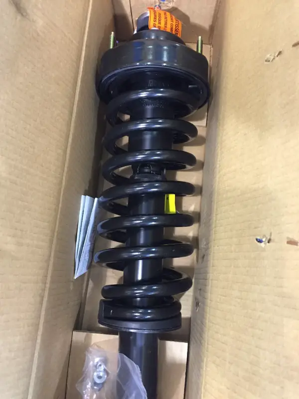

My right rear Monroe quick strut is really squeaky. Something I may have caused while going off road. Ordered a replacement and this is what was in the box.
Had the store reorder it and will see what I get today. If the non variable rate assembly is better (stiffer) then I'd gladly go with them, but I'm not going to run variable and non variable at the same time.
