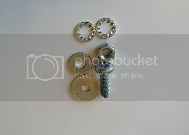

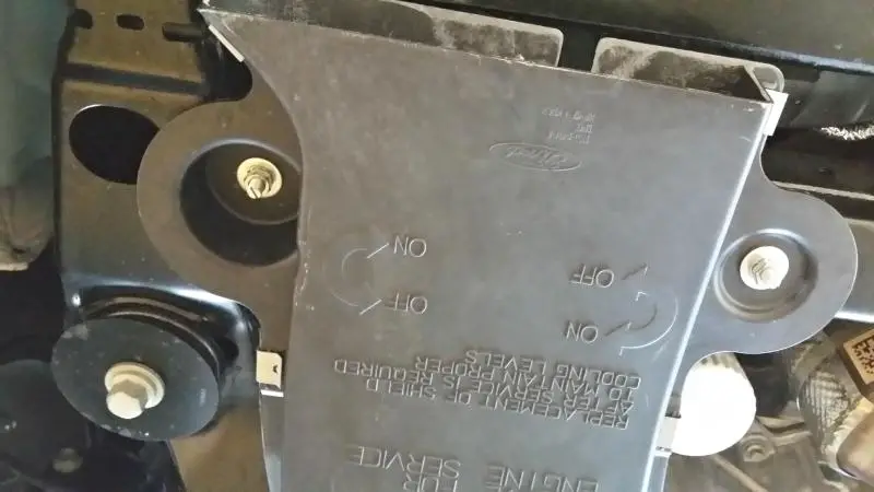

After changing the oil in my '15 Sport the other day, I was about ready to pat myself on the back and thank Ford for one of the easiest oil changes ever. Then I started putting the cooling shield back on...
When I removed the shield I had to use pliers to get these little bolts out. Whoever installed them at the factory must have cross-threaded them. So when I went to put everything back together I was S.O.L. Also destroyed all the blue spring-clips that these bolts threaded into.
I didn't want the hassle of having to explain/convince the dealership that what happened wasn't my fault and that they probably needed to fix it, so I just bought some bolts, washers, and star lock washers at Home Depot and fixed it myself. Had to get just the right combo that would fit into the holes in the chassis without falling back out (kind of a pain) but everything went back together just fine. I used a hacksaw to cut slots into the bottom of the bolts in case I needed to use a flat head screwdriver to keep them from turning when I tightened the nuts, but it turned out it wasn't necessary since the star lock washers held everything in place.
Hope no one else had this issue! But if you do, there's always hope!!!
Had to use a drill bit to enlarge the hole on the bigger washer.
Any info on the type of screw that you used?

Hey, Ford Engineers. Check this out. LMAO.......... Only problem now is, when you hit the scoop off something it's gonna make some damage. Be careful out there. I hit a pothole and it ripped my scoop off. With those bolts on there it'll probably tear the scoop apart and maybe bend something

When I did my 1st oil change I found that the aft fastener on mine didn't line up at all and they just forced it to fit. I ended up bending the metal bracket to make it fit correctly with no stress on it, then all of the camlocks went right in.

I agree, it is not about the cost, its about knowing it is done right. The dealers use novice techs to do oil changes and most do not care and some do not know what they are doing. The tech that changed my MKT oil did not tighten the two rear aero pan bolts and the shield started dragging on the way home. They also used the wrong oil weight. You have to read every invoice to make sure they don't screw something up. The oil fill cap says what oil to use, but I guess the tech can't read.

Edit: Tony those air duct bolts are a pain in the ass. One of them worked its way out and let the front of the air duct fall while I was driving. Of course this caused the duct to catch and rip itself to pieces. It also tore out the rear blue spring clip the rear bolt screws in to. Since I was in a hurry to leave on a trip and didn't have time to have it serviced, I just had my dealer parts department order me a new air duct. It cost $65, and I need to go back to the service department and get that covered under warranty. The new air duct is now bolted in, and has a couple of zip ties (because I'm classy) for extra protection if the bolts come out again.
