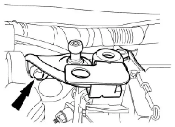

1. Remove the upper air deflector.
2. Detach the A/C tube from the retainers.
3. Remove the inner air deflector.

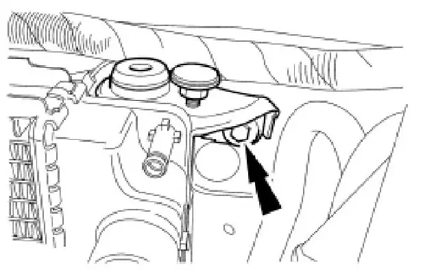

4. Remove the bolt and screws from the left side of the fan shroud. Discard the screws.
5. Remove the bolt and screws from the right side of the fan shroud. Discard the screws.
6. Remove the radiator upper fan shroud.

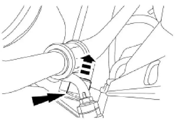

9. Disconnect the cooler lines if equipped.
a. Remove the safety retainers from the connectors.
b. Use the special tool to disconnect the quick couplers.
c. Loosen and remove the screw clamp from the hose.

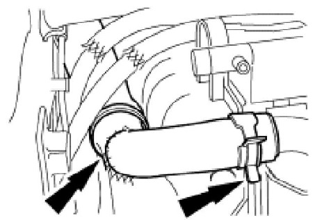

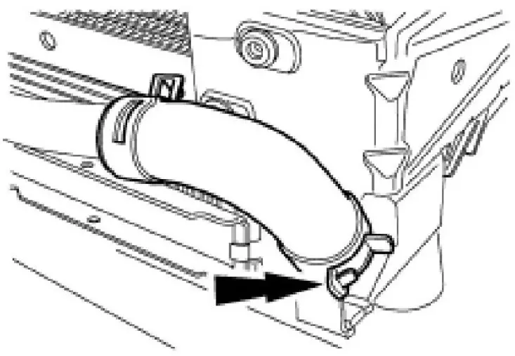

10. Disconnect the hose from the radiator, detach the hose from the retainer(s) and position it aside.
11. Remove the left lower radiator hose from the radiator and position it aside.

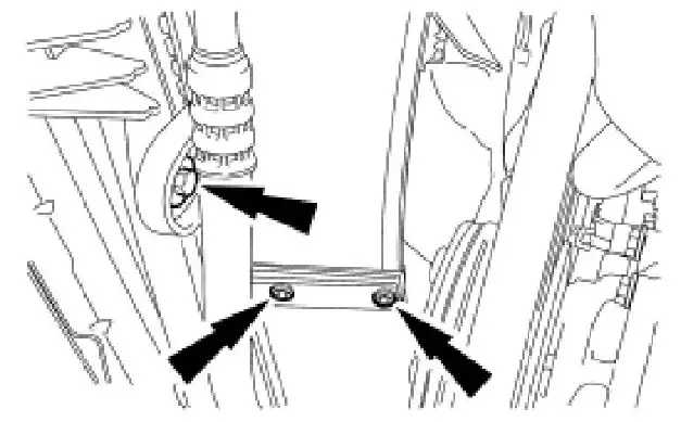

12. Remove the bolts and the lower fan shroud.
13. Disconnect the lower air dam pushpins.

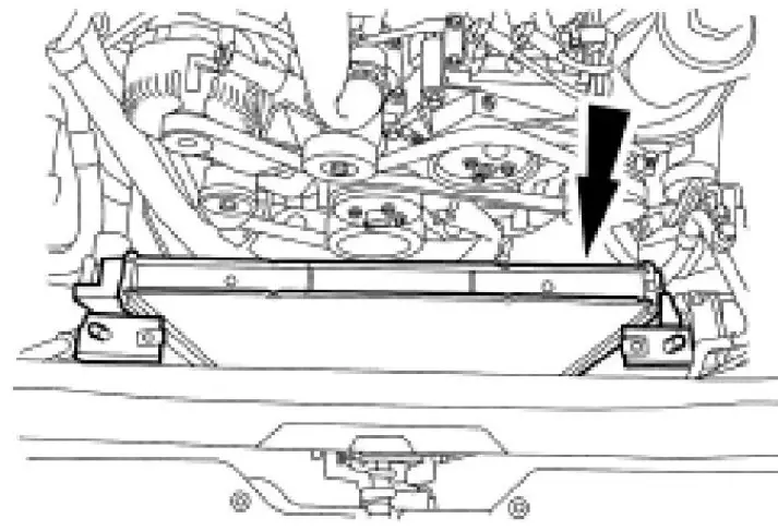

15. Disconnect the degas bottle hose and upper radiator hose.

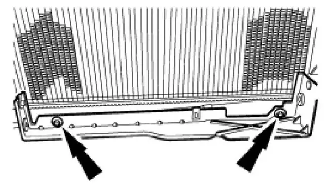

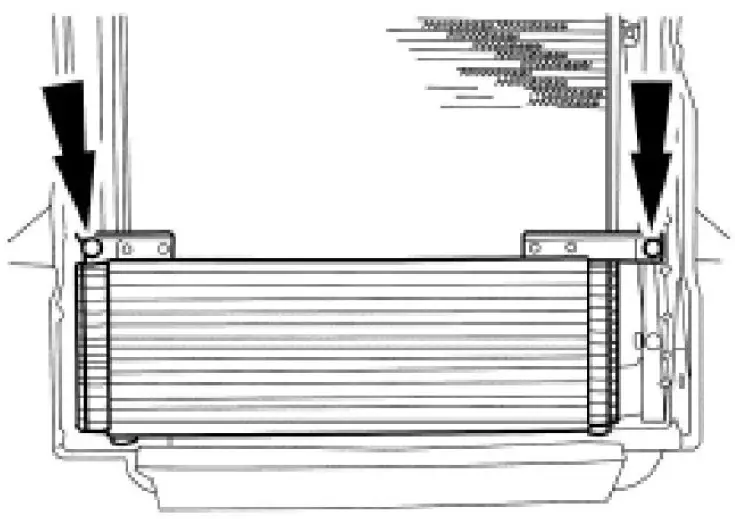

16. Remove the two bolts and the right radiator support bracket.
17. Remove the two bolts and the left radiator support bracket.

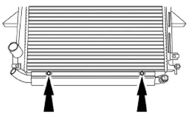

25. Remove the bolts and the trans cooler.
26. Remove the splash shield pin-type retainers.
27. Disconnect the hose.
28. Remove the four bolts and the bracket.
