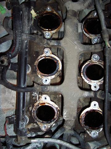

My apologies 2000StreetRod. I had rockers and valve springs on my mind and didn't explain this very well at all. The image below should clarify. If not please let me know. Also, do you know of a good link to a guide on how best to take off this head? The right head? Does Haynes do a good enough job? Thanks again

OK, so there is coolant in the intake ports for cylinders 2 and 3. Is there any chance that the fluid fell into the open ports instead of leaking from a cracked head? If so, I suggest suctioning out the coolant and pressurizing the coolant system to confirm the leak source(s). A new set of head bolts, intake & exhaust gaskets are not inexpensive. And then there is the time to remove and install the head and time the camshaft.

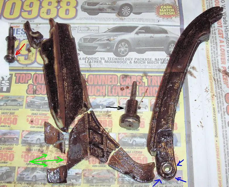

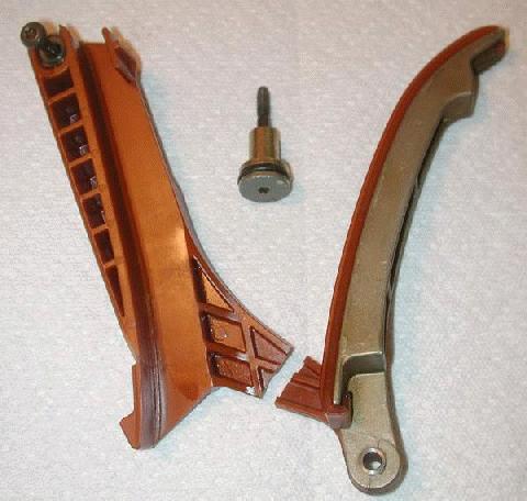

There are two common points of failure for the right cassette guide assembly. The top where kept in position by the upper guide post.
And near the pivot point.
Mine was broken in multiple places.
Your upper guide post section looks good. But it could be broken down below. Try pulling upward on the guide. If it moves more than about 1/8 inch it may be broken below.
The improved right guide assembly has metal reinforcement on the slack side but none on the traction side.
The old guide assembly has no metal reinforcement on either side.
