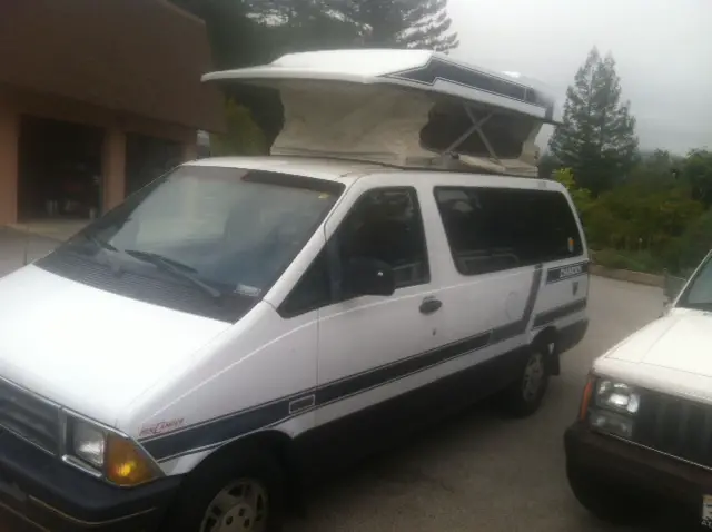

There should be 2 pics here, one with the Chinook-aerostar top down, and one with it extended (should be tighter), giving about 6'6" standup room. My unit didn't have anything inside in the way of camping equipment, other than an AC input on the driver-rear exterior, and an AC output behind the rear seat. There was a worn out bed that extended from under the heavy wayback seat that I recycled. I understand there was originally a removeable DC cooler, similar to the Vanagon Weekender poptop.
It's a good looking, durable fiberglass top, I think, what you'd expect from the Chinook folks. It's raised by springs on scissor lifters, on front and sides. Not much weathering after nearly 20 years even the canvas sides are still in pretty good shape. the scissor attachments at the raised fiberglass roof gasket need rework, probably threaded inserts, where screws go into the fiberglass

OK, I lied; you can see that the third scissor support is in the rear.

Thanks for getting an elite membership! This is the first time that I've seen an automatic pop top . Could you take a picture of it from the inside? According to what you've written until now, you're saying that this was OEM (ordered from the dealership brand new with this top)? This wasn't something that was added later on by a specialty shop? I have Ford manuals, CDs, DVD's, Haynes, Chilton, and Clymer, and never came across this.

Chinook top is spring assisted, not automatic. You can see one of the vinyl sleeved springs in the pic, masquerading as a pneumatic lifter. The internal clips and velcro have to be manipulated before pushing it up. There are OEM planks to make up a kids bed at roof level, but no upstairs sleeper a la Westfalia vanagon.
