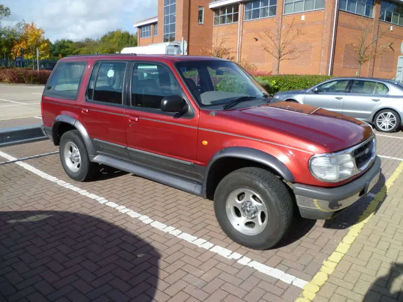

Thanks for that as I am a newbie what does 2" of lift give you?
Here is a pic of mine with 2" lift shackles made by kevp. I fitted the shackles then wound the front torsion bars to match. Kev p also supplied a bracket to alter the position of the ride height sensor for the ARC system so this is aldo something to consider.
