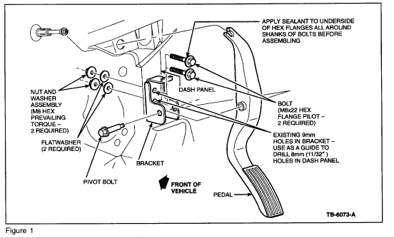

My 98 LTD 4X4 SOHC's gas pedal bracket fell off the fire wall, gas pedal is laying on floor! Could someone post the detail for TSB Nov 00 # 00-24-3 titled: accelerator pedal bracket - cracks & fatigue? Anyone had this happen already - and advise how you fixed it? It appears the spot welds have broken off the back of the bracket where it was attached to the firewall. Thanks in advance!! :)

Refer to Figure 1 illustration throughout Service Procedure.
1.
Remove accelerator pedal pivot bolt and pedal from bracket.
2.
With bracket placed in original position on dash panel, use the two (2) holes in base of bracket as pilots, and drill two (2) holes in dash panel using a 9 mm (11/32") drill.
3.
Examine dash panel on engine side for any cracks related to the attachment failure. If cracks are present, clean the surface with a suitable solvent and apply sealant to the cracks, such as RTV Sealant (F5TZ-19G204-AB).
4.
Apply same sealant on the underside of the head flanges and all around the shanks of two (2) M8 x 16 hex flange Bolts (W500022-S309).
5.
From inside the vehicle, with bracket held in original position, insert bolts through holes in bracket and dash panel.
6.
On engine side of dash panel, assemble on (1) Flatwasher (391982-S191) (7/16" ID x 1.0" OD), and one (1) M8 prevailing torque hex flange Nut (W520112-S309) on each of the bolts. Tighten nuts to a torque of 27-33 Nm (20-24 lb-ft).
7.
Replace pedal and pivot bolt and tighten pivot bolt to a torque of 9-12 Nm (80-108 lb-in).
8.
Check accelerator pedal for proper operation.
