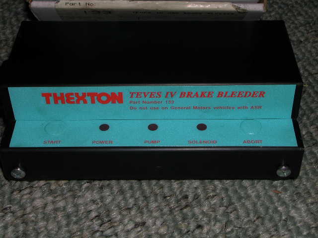

The 92 am 93 manual's do not discuss the need for the special tool (the FORD tool is a (year of mfgr) -50-ALA- adapter. 94 started talking about the need for it to eliminate air from the master hydraulic control unit. There was an aftermaket unit sold as well (I have one for sale if there is any interest). I have the FORD unit if anyone wants to see pics. But for 92 and 93, according to the manuals, not necessary. I've manually bled my 92 - front and back with success. HTH.
Here is the aftermarket unit
Here is the XX-50-ALA Ford unit
and a view of the "business end".
I think this bleeder was also made as 94 - 50 ALA and maybe even 98-50-ALA. THINK. not sure.
