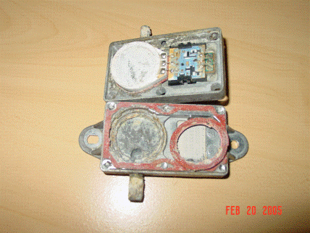

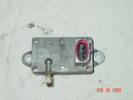

this is what it looked like though the stupid metal one...

i can not believe that much heat comes thru this thing as others are saying a torch effect wow. makes me think i should change my cheap hoses i put on them..
