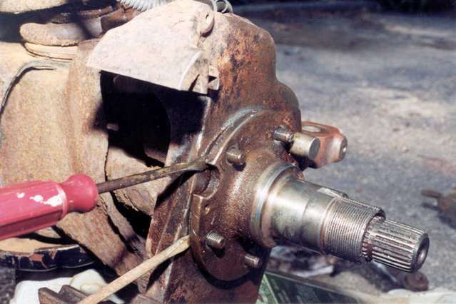

I would have responded earlier, but was on vaca. I am glad you got the spindle off. I laughed my @$$ off when people say tap the spindle gently with a rubber mallet and it would come off. I beat mine every which way for over an hour with Zero result.
I ended up using several screwdrivers as wedges to pry the spindle from the knuckle. Even with this method it took 30+ minutes each side.

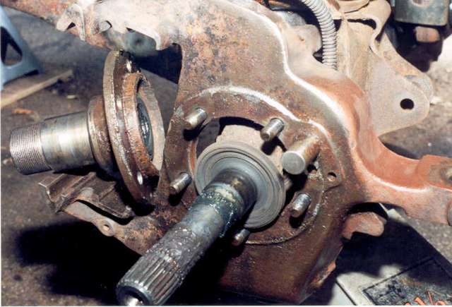

In this pic you can see the real culprit (a lip on the spindle). This spindle lip is actualy pressed into the knuckle. I wonder if all spindles are this way? I had read a manual and it had a pic of a spindle without this lip. So if it is true then it would explain why some people can remove their spindles easily..
**Update** The easiest way to remove a stuck spindle is to put the large axle bearing nut back on the spindle and pull it off with slide hammer. A few pulls and it yanks right out.

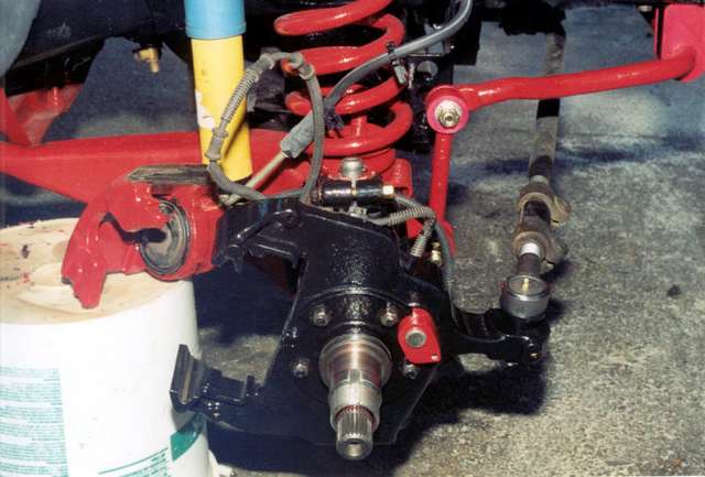

After disassembly I sandblasted everything down and coated the mating lip surfaces with anti-seize. You will be able to fit the spindle back on over the studs and start the nuts before things get tight. You then keep tightening each nut 1 turn each until the spindle is seated.... When seated, torque each nut 40-50ft/lbs (1st gen spec).
Note: Use Loctite and a cross pattern when tightening the nuts. I would recommend you replace the Spindle bearings and seals while you have it apart. You use a 3-jaw puller to remove it (AutoZone free rental)..
  • Bearing (2) (Timkin B2110)
  • Seal inner (2) (Motorcraft)
  • Seal outer (2) (Timkin 722109)
Here is my completed re-install. All parts were coated with POR-15.
