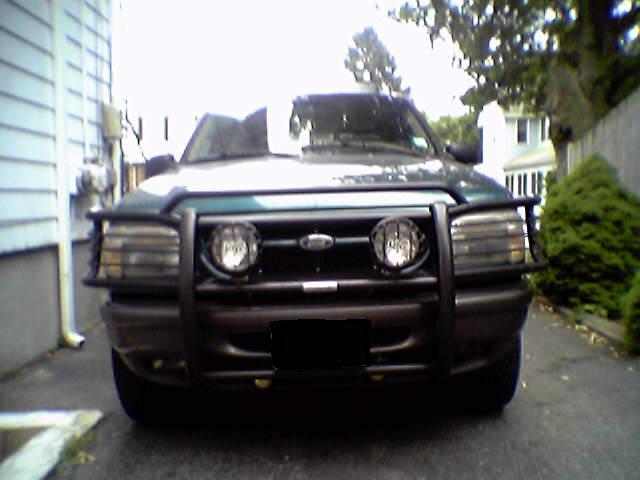

Also, I see you have a Manik Brushguard. Do you have a picture, I'm in the market for one.
here is a pic of my manik guard w/daylighters
Bentley~ Thanks... did you have to 'notch' the lower valence and if so, how much and do u have a pic? Thanks buddy.
no notching required it fits in there w/o notching. although over the years it has guard has pushed the valence down slightly but it isnt really noticable unless you see it at eye level.
Did you squeeze it in the opening between the 2 fogs lights? I didnt know that was possible. I thought you HAD to notch it out and it went under the front valence.
yeah there are 2 openings between the two fogs that it fits into. I will take some pictures in the morning because i dont have a flash on my digi-cam.

Thanks for the pics. Since it fits in that opening, why does everyone say you have to notch the bumper? It looks like you just squeezed it in there.
