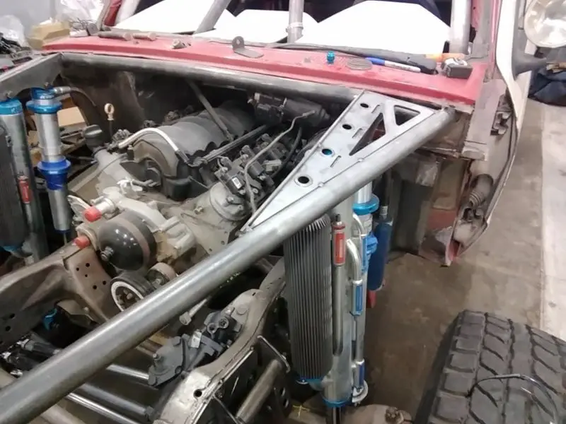

Correct new motor mounts used dirt dingo 240z mounts used for this install in stock location , I’m having my motor pushed back so the crack pulley is at about the cross member where the engine currently sits here’s a pic of what it should look likeThe Ls fits in the stock 4.0 location? I assume new mounts and whatnot are required
Jesus that is stuffed under there. I assume that is to keep the truck balanced front to rear?Correct new motor mounts used dirt dingo 240z mounts used for this install in stock location , I’m having my motor pushed back so the crack pulley is at about the cross member where the engine currently sits here’s a pic of what it should look like
pre runner!!! yeah buddy it is for balance so you do not nose dive
those are some nice kings holy moley long live the beamed trucks

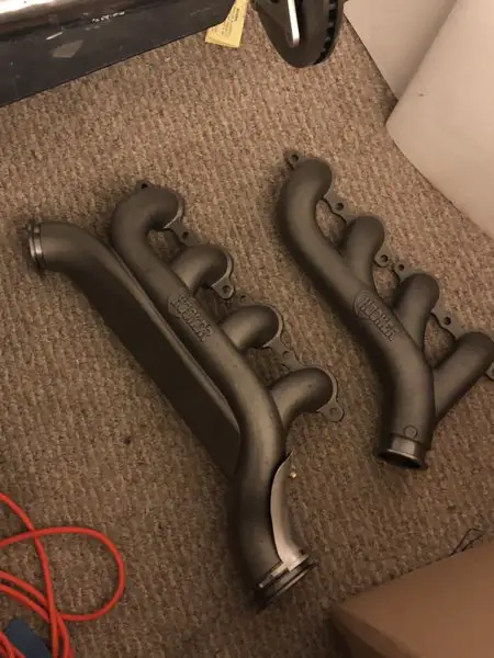

Still got about a month or so till truck goes into shop they said mid November, ordered some other parts see if they fit since I have all the suspension stuff already so this should keep me busy See if they clear the frame and steering, won’t be able to test fit till this weekend they are hooker ls turbo headers if they do fit I’ll do the eBay special Turbo and do 7-8 psi and call it a day, also got some high clearance radius arms will be installing those tomorrow will post pictures up

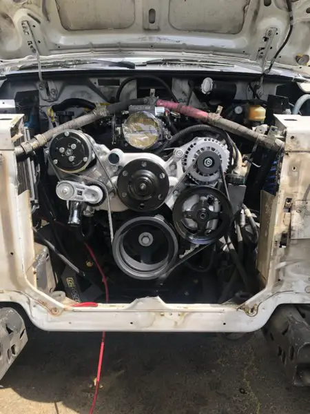

Is the motor still in its original position, Or did you move it back in the chassis already?

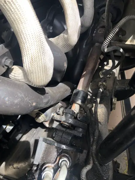

Curious how the steering shaft and steering box fit with the manifolds and all that, and how well it cleared the HVAC box on the right side.

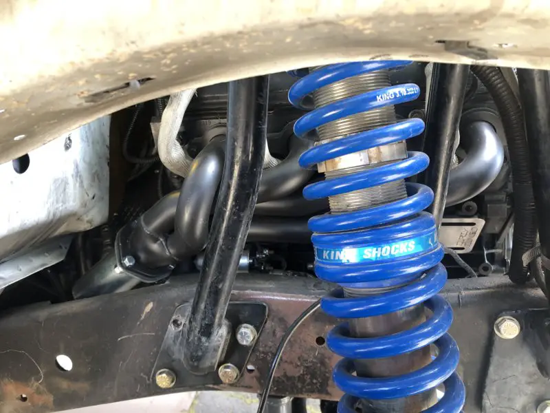

Here some pics of the header clearance and ended up switching the truck accessories to the Holley mid race accessories
