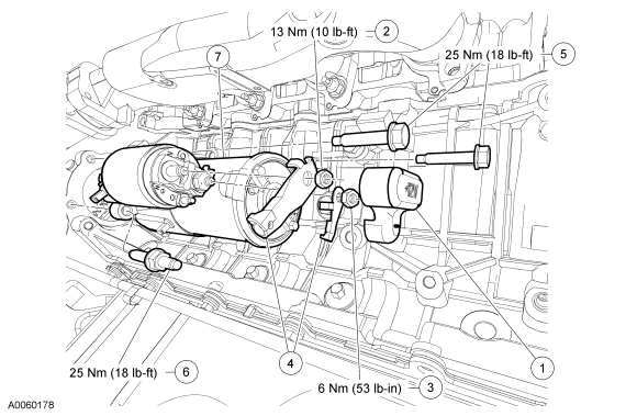

Also, what is the correct torque for the starter bolts? Thanks in advance!!

Torque for starter bolts?
https://www.scribd.com/doc/243732897/Starter-Motor-Removal-and-Installation
