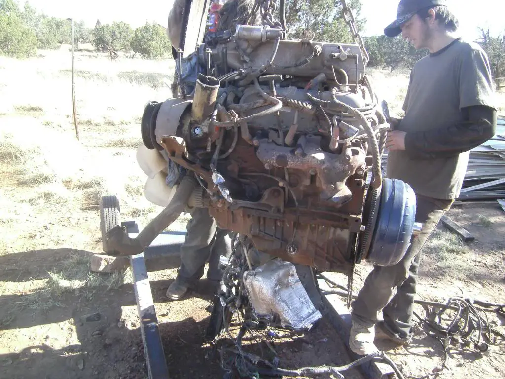

This is how the engine looked when I pulled it out (not the exact engine but I pulled both engines exactly the same way)
